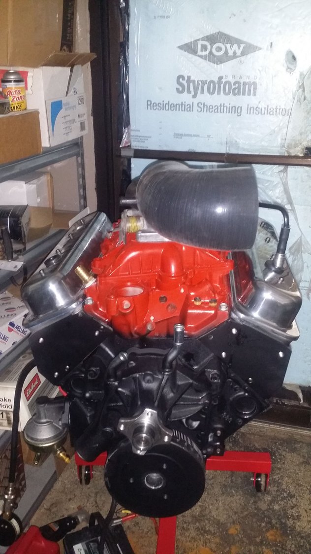

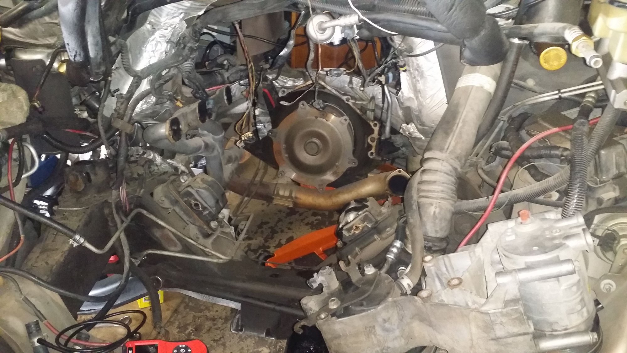

Actually in the middle of dropping my 383 back in myself. Have some engine compartment cleaning, wiring harness repair and reloom as well as a few other things to do before it goes back in.
