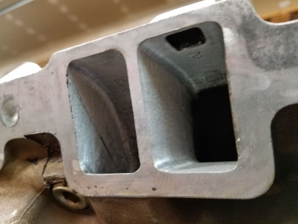

Recently done a 350 TBI swap. L98, stock cam, headers+3in exhaust, mildly ported heads, 15lb spring, bored TBI and intake. Good chip tune on it car has ran great the first 3 months couldnt be happier. Now.. Every now and then for no apparent reason or warning you can be cruising along and get in the throttle and it feels like a 4cyl and not a turbo 4 cyl. Also when it does this the engine will warm way up to around 220+. I have a 180 thermostat and a fan switch that turns on @200 and off @180.. Until this week I havent ever seen it hardly get above 180 and no hiccups in the way its ran so far.We checked fuel pressure when doing the install and had great fuel pressure in fact the fuel pump has been swapped to a higher flow at some time or another as it was putting out almost 60 lbs pressure.Im wondering if I may have an injector sticking making the car run lean? Will running lean make it heat up? Im just wondering what could be causing this issue. Could it be a crappy distributor?
