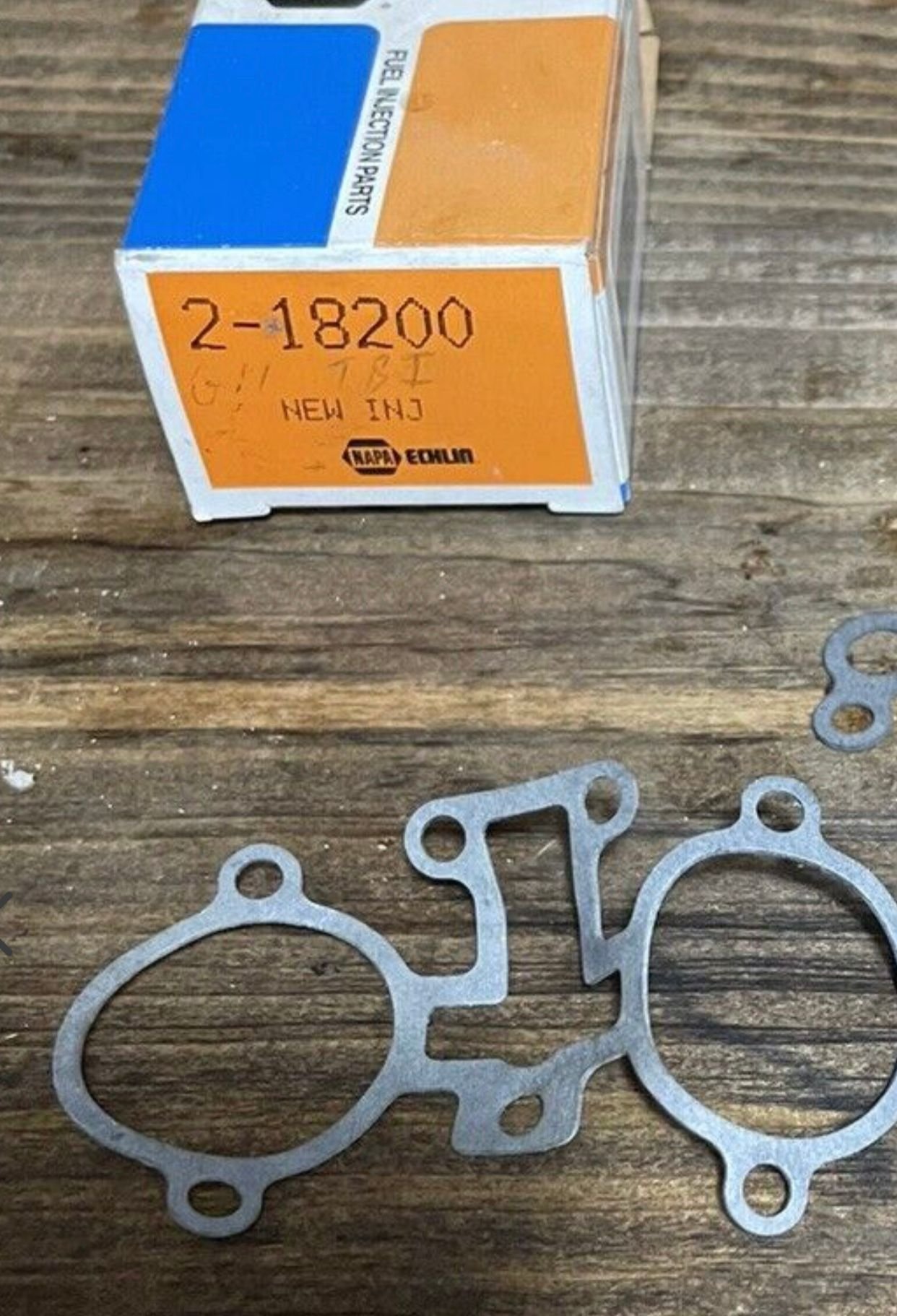

Last November one of the injectors failed on my 90 Camaro rs with 305 tbi. I replaced the injector with a Standard one I got online. That one came with the gasket. Fast forward a year and the other injector just failed. I couldn’t find another NOS standard one on eBay so I ended up buying one from the local auto parts store and it doesn’t come with this paper gasket and the auto parts store can’t find a listing for just this gasket. Anyone here know the part number for it and where I can get it? Worst case scenario I’m hoping I can maybe we use the one I installed last year, I put gasgachinch on it so hopefully it won’t rip apart when I disassemble the unit

Also,does anyone here know if this injector would work for my application? It has the correct gasket,the part number in the box is 2-18200. it includes the injector and gasket I need. The injector looks the same but the part number shows it being for an 84 Camaro not a 1990. I didn’t want to buy it if it won’t work for my apllication.

Thanks “Shifty”,I only need that one gasket though,not the entire kit. The last injector I bought had that one paper gasket with it. The injector they sell at Autozone doesn’t come with anything beside the two rubber o rings. If that other injector will work I can buy that one,it has the one paper gasket with it.

https://www.ebay.com/itm/17423306503...UaAla6EALw_wcB
Just search TBI injector pod gasket.

Thanks again ShiftyCapone for helping out. Guess I’ll have to get that one. They used to sell those for a couple bucks a couple years back! Beats spending $30 on a kit thought.
As far as the other question,I guess someone must have bought that injector I posted a photo of here because it vanished this morning. Supposedly it didn’t fit the 1990 Camaros and was a for a 2.5 motor,but the gasket and injector sure looked the same. I was wondering if it would have worked. Oh well.

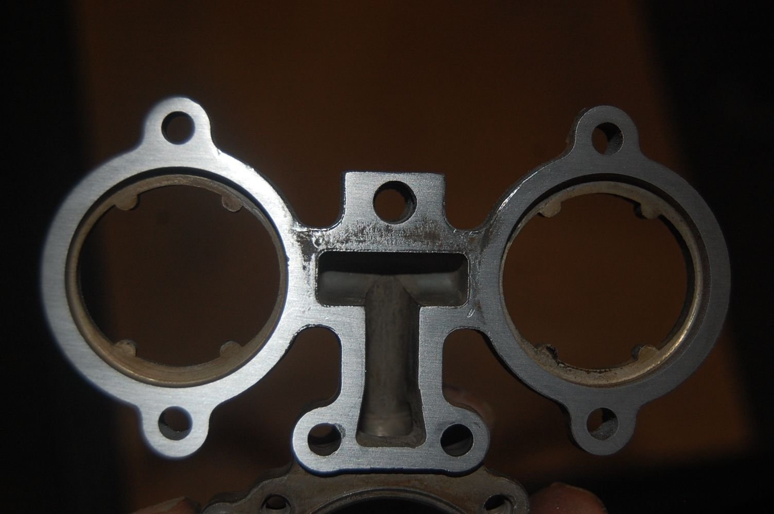

https://www.carburetion.com/sitesear...ochestor%20TBI
I re-use those gaskets (unless they're visibly damaged) after I assure the metal piece on top of it is actually flat. OTOH, "$30" for a kit gets you the base gasket and the pressure regulator diaphragm, too, along with all the other gaskets. I keep a kit on hand.
"Double-Strength" glass plate for flatness, some 220-grit sandpaper. All I need to "re-machine" the injector cover.
As removed.
A few swipes across the sand paper. Not at all flat...yet.
Getting better. Still high in the middle.
Good enough for me. Could have scrubbed it until all traces of pitting were gone, but the gasket will easily seal this piece.

Funny thing about the '84 injector having that gasket. An '84 would be a Cross-Fire setup, uses two 1-bbl units. And doesn't use that gasket.
In our f-bodys the 2-bbl TBI unit was used until '88.
