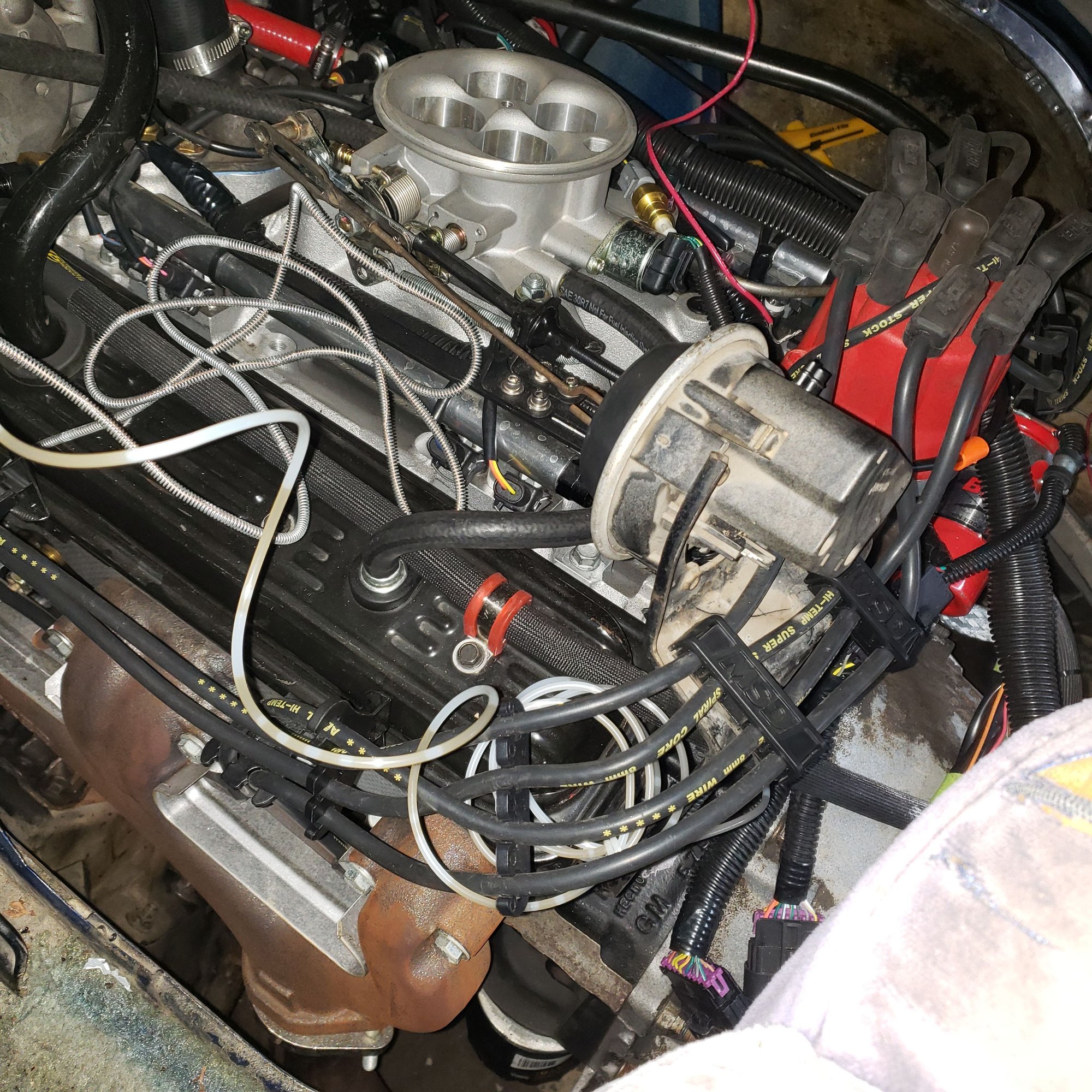

I forget the part number, but it is the supercession for the 929 cam. The newer part number is the same part number used in a LU3 Crossfire 305 and GM Heritage has the full specifications in their Camaro information package for it.
I have an aluminum dual core replacement that is dimensionally the same as your older 4 core in my 87 G20 with a ~380 hp L31 350 in it. Radiator manufacturers claim the dual core design sheds even more heat because the larger tubes have more surface area. Runs cool as can be with an 11 bladed plastic fan. I ended up using replacement oil cooler hoses for a 99 Tahoe and they fit pretty well. The van ones are unobtanium now.
I converted to the L31 accessory brackets and accessories. The TBI PS pump bolted right on the vortec bracket. I swapped to a 145a AD244 alternator and upgraded some of the wiring from that crappy junction post behind the battery. Proflow 4 injection with a new Vortec pump on a new sending unit in a new tank. Upgraded from the 22 gallon tank to the 33 since I was buying new components anyway and it only required another $15 in new mounting straps. The 33 gallon tank was a few $ less so it was a near wash. Gave the old pig a new lease on life. The Hooker 2.5" manifolds fit like a glove, but I wish I had gone with headers instead. One of the things I actually like on this 87 is it has the 3L80 aka Turbo 400 with a TH350 output shaft and a 3.08 gear for screaming down the interstate.
