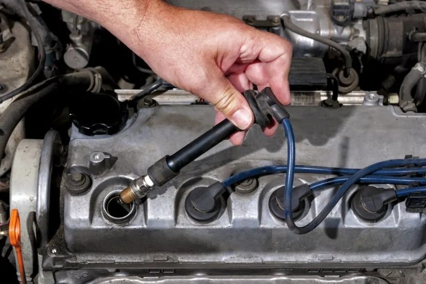

You could also check for spark the old fashioned way, put a plug in the boot, ground it to the engine and turn it over.
Make sure you put that coil-Dizzy wire back on

hook everything back up. Remove the plug wire from the dizzy that goes to the coil, the short, center wire. Put a spark plug in the end that would plug into the dizzy. Ground the plug, you can use the center post on the dizzy or elsewhere. Turn over the car. The plug should spark if the coil is receiving the signal.

I removed the plug wire and put in a spark plug, no spark came when i turned it over.

Yeah, an ordinary spark plug is better than nothing. However, it's a poor test of the voltage capacity of the coil. A spark plug in air takes very little voltage to jump the gap; and it won't jump the gap at all if the plug is fouled.
That's why decent spark testers have a huge gap--to compensate for the lack of 150-ish psi of compression pressure trying to snuff-out the spark. HEI spark testers have an even bigger gap than those for ballast-resistor ignition systems, to properly-load the ignition coil.
HEI spark tester on left, Ballast-resistor ignition system spark tester on right
Recessed center electrode of HEI spark tester at left produces larger spark gap, vs. visible center electrode of ballast-resistor style spark tester on right.
With no spark at the spark plug end of a plug wire, re-test at the coil wire going into the distributor. If you have no spark there, I suspect the coil, or--more likely--the ignition module.
But that assumes that the distributor shaft is actually turning, and the wire harness between distributor and coil isn't faulty.
