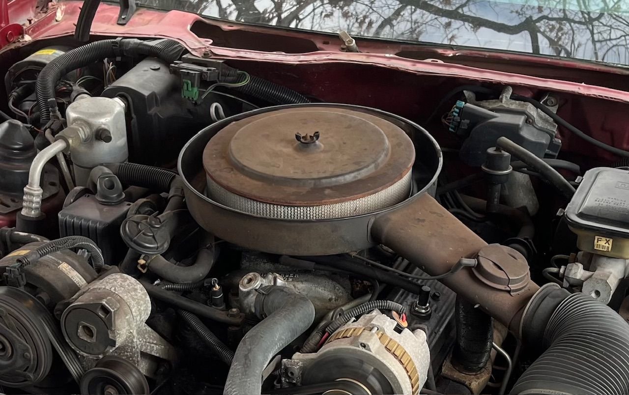

Bought his 91 RS a few weeks ago. This is my first 3rd gen and really first project car in general. I was going over the engine bay and it's filthy! Then I saw the air cleaner and noticed that it looks like the top was removed and replaced with what looks like an open element filter... The strange part is, the snorkel is still attached(which wouldn't be doing much), and the PCV hose is still attached to the outer wall of the original system and venting basically into the engine bay which is probably why it's so dirty.
Is the way its running now a problem? Or should I buy an oem style top and filter asap?

Previous owner was a moron. The only way that system works well is if there's some sort of "hood" air intake--"cowl induction" or similar. Then the hood and associated components act as part of the air cleaner housing. But you didn't mention anything special in terms of the hood.
Find a proper lid. It won't make as much noise, but it's likely to actually work better.

it does have a monstrous cowl hood. That might explain it. So basically the lid is off so it can intake from the cowl. Sorry I’m new to this stuff. Thanks for mentioning the cowl, I wouldn’t have considered that to be a factor otherwise!

A "real" cowl-induction hood is SEALED to the air cleaner, so the ambient air can't bleed out and fill the entire engine compartment. GM sealed all their "hood air" vehicles, including Chevy Cowl Induction, Pontiac Shakers, Olds OAI, and whatever Buick called their system. They were sealed with rubber strips, or with foam. The "cold" outside air was reserved for the carburetor.
Same for Chrysler, same for Ford.
But when it's a cheap aftermarket hood installed by a Bozo, the "cold" air bleeds all over the engine compartment, has no proper drainage of rainwater, and interferes with the hot air coming through the radiator.

I'm guessing the guy lost his air cleaner lid and bought the first/only similar lid at the bone-yard he could find so he had something there. The best thing about it,.. your only taking in filtered air; the worst part about it is that your not water tight.
For a temporary solution you can use an 80's GM 350 truck air cleaner lid,....... it's a little taller than a Thirdgen air cleaner lid and allows for a larger than factory filter. At that point your getting cold air again, and the air cleaner can't get water in it so you can take your time to decide on sumthin' more permanent.
