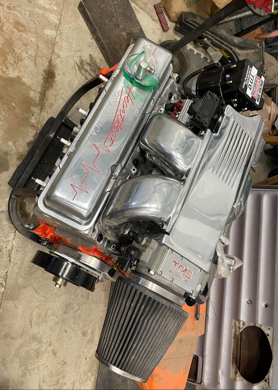

my 400 sbc build
4.185 bore, dished pistons, 10:32 compression. Comp cams retrofit roller cam 12-423-8, AFR 180cc Eliminator heads 1.52 rr. Slp ported runners and Edelbrock tpi base 58mm tb using a 1227730 ecm.
