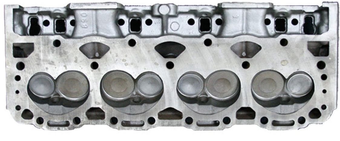

The Mexican 062 350 heads that have been sold over the counter for the past ~20 years flow worse than the 059s do. The 350 heads will perform worse than the 305 heads on a 305. Heart shape chamber does nothing fpr a smaller bore engine either. The 305 heads burns just as quickly as the 350 head if not a little quicker. Meaning a 305 Vortec actually usually ends up running less timing than the 350 Vortec to make peak power.
The 601s they removed from the 305 should have been 53cc. Also have to wonder if they put the correct reach plug in the Vortec head.

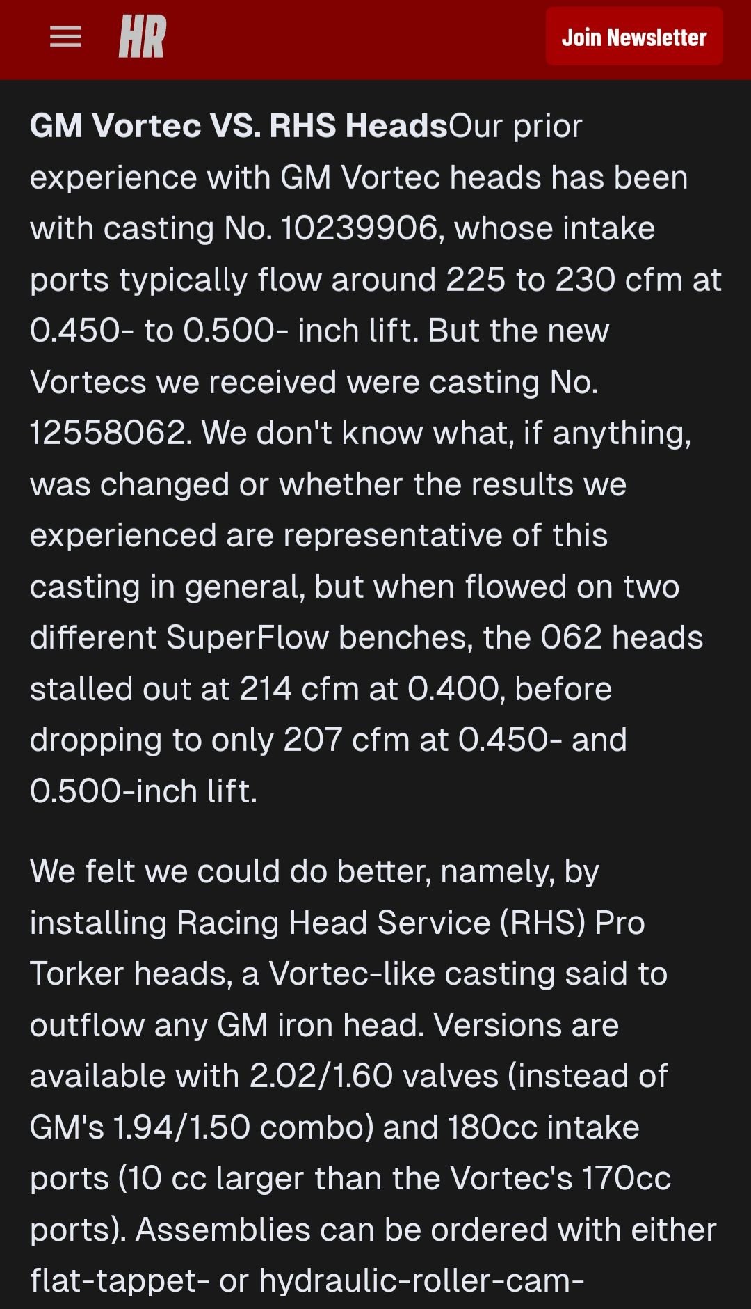

Well here, 305 Vortec heads were only worth 17 hp and actually made less torque than with the 601s. I know you've been a proponent of the 305 Vortec head for many years, but I've never seen any actual data on their outperforming 350 Vortecs on any engine.
This guy flow tested GM 350 Vortecs, Mexican Vortecs and GM 305 Vortecs. While the Mexican Vortecs did underperform the GM 350 Vortecs as you said, they still outperformed the 305 Vortecs everywhere except at .600 lift. The Original 350 Vortecs crushed the 305 Vortecs.
According to Scoggin-Dickey, though they still sell Chevrolet Performance p/n 19436449. The flow numbers they list for that head match the traditional Vortec numbers (239 cfm @ .600), and they're available all over the internet for 600-650 bucks, each..
https://sdparts.com/i-24502323-chevr...5WdeHP1w6Q8W60
https://www.youtube.com/watch?v=qy90bOCTpjM

I ran 059s at ~10-10.5:1 not 8.5:1. Also single pattern cam is where it is at for a 305. They lost a substantial amount of that torque because they crippled the compression ratio. I do not see anyway in the world a flat top piston, GM 0.020" thick head gasket and 53cc 601 head was only 9.00:1. They are close to a point low on their compression calculation. I also question if they put the correct reach of plug in the Vortec heads. Very common mistake and cost a bit of power.
GM does not sell a production equivalent Vortec. Those are the over the counter Mexican heads I was talking about. The 062s vs 059s I flowed did not have the Mexican 062s up in flow anywhere compared to the 059s. That being said my untouched 97 906s reached 242 cfm on the same bench.

I do not care what you read somewhere. The newer GM over the counter Vortecs did not flow 239 cfm nor did the ones on the crate engines. They were Hecho en Mexico GARBAGE for years and only flowed about 215 cfm @ 0.400 and dropped off to 207 cfm @ 0.450+. Well documented by myself and others including HotRod Magazine and Cutters Performance. So yes you should definitely care where your Vortec heads were cast. The Mexican heads cracked between the seats like clockwork.
I also had one of those "Goodwrench" crate engines from the 2005 time frame. It was a POS. The Mexican 062 heads cracked and it also had a crank journal out of round that knocked out a rod bearing in 40K miles. That POS is the reason I built a 383.
