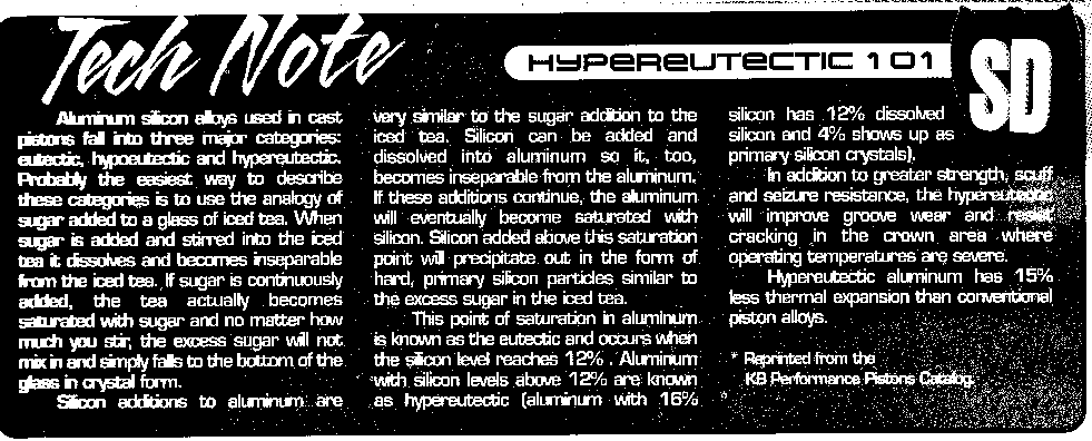

FJK is right when he talks about the silicon content in all cast pistons. I just want to add one thing.
Ever heard of the term "saturation," in a chemistry context? "Hyper" pistons are saturated with silicon. This gives it the characteristic hardness (and unfortunately, brittleness). I believe the point at where a casting alloy becomes "saturated" is a little higher than 13%, tho.
Hyper is a cast piston, with EXTRA silicon added past the point where the silicon no longer dissolves into the aluminum. This isn't as bad as it sounds for strength.
Forged pistons are basically better because they are pounded (or "forged") into their basic final shape at high temperatures. This means that the grain (or molecular flow) of the base stock aluminum is unmolested, and therefore stronger.
Cast pistons have little very little grain from the base stock, because they are poured into a casting from a molten state.
If you've ever looked at what makes a connecting rod strong, the same basically applies to pistons. Making sure the grain, or molecular flow, is even and smooth is important to the strength.
