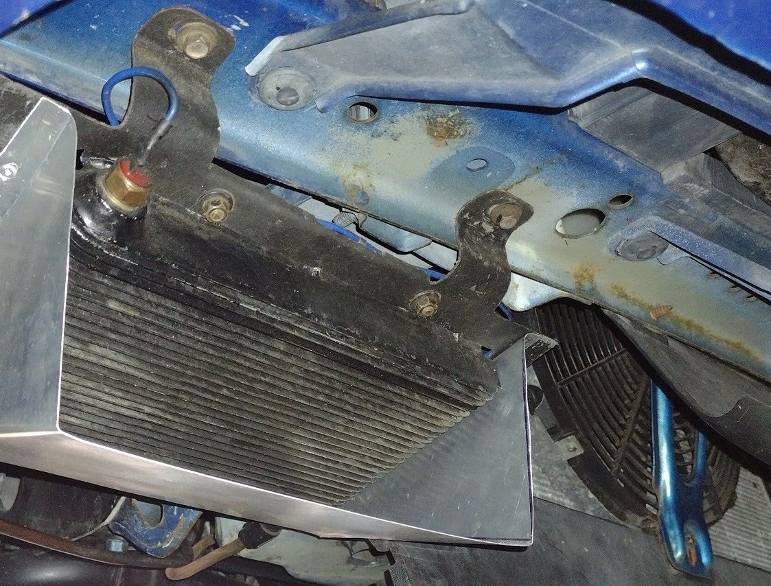

I can't use puller fans as I've got a huge turbo in the way. Hence why I'm using a pusher fan. Keeping the engine cool isn't my problem at all. I got it figured out

I ordered a new radiator and fan, same stuff I've currently got in the car, I'm gonna use some of those little L shaped brackets and I have a few aluminum weld nuts laying around that I'll have welded to the radiator and I'll bolt it in place instead of using the push thru radiator ties the fan comes with.

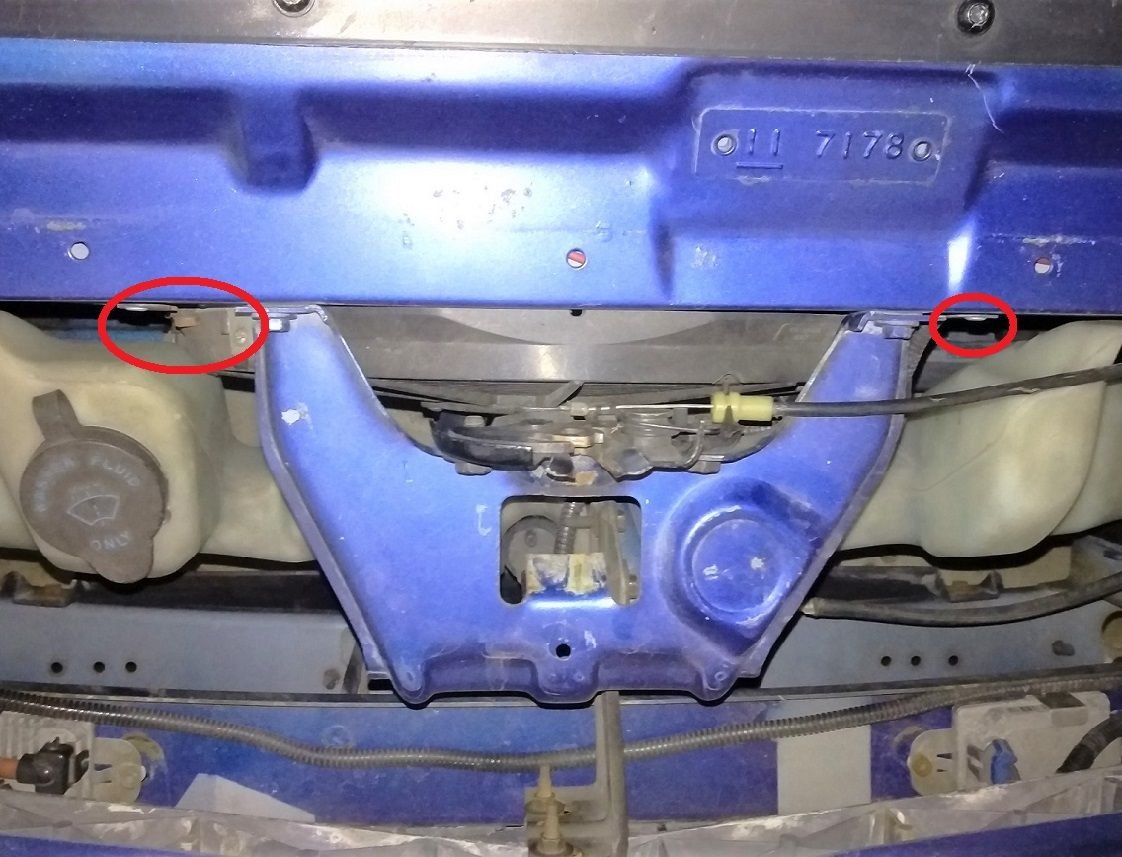

I mounted an 14" aux fan (spal) between the hood latch brace/rad. Made a bracket/riveted to the bottom of the fan. Lower bolt on the brace sandwiches said bracket.
The top is held in place by a similar fashion (red). Also fabricated a small shroud to close the gap between the fan/radiator.

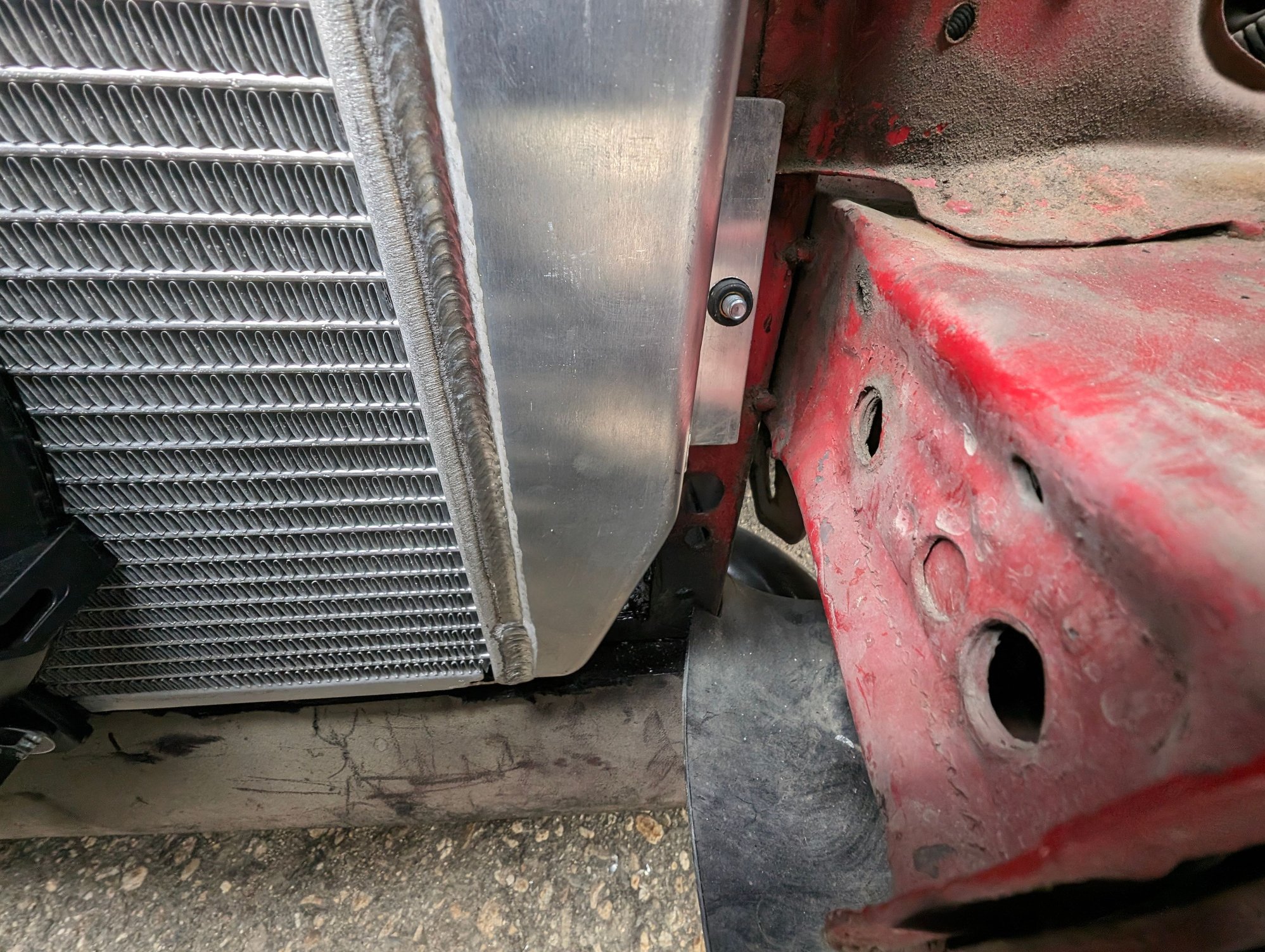

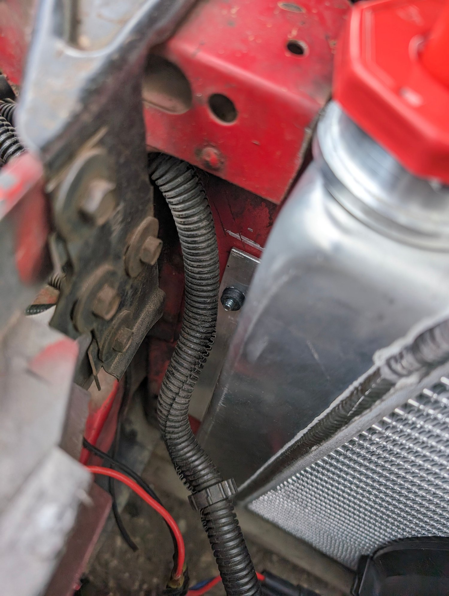

Got the new radiator and fan setup in the car. But man oh man has it been a bear to get the air out of the system. I thought I had it on the first go I had my coolant funnel on and watched all the bubbles and cycled it 2-3 times thinking I was good to go. But I noticed it would heat up fast but not to the point of overheating so I put the funnel back on and got it up to temp but this time I cracked open my steam vent line and sure enough a whole bunch more air came out and I got another half jug of coolant in there.
I mounted the radiator a bit different too, I took it to the welder and had him weld on some 1" angle to the tanks I then drilled a couple holes and used well nuts to bolt it into the car instead of using that big ol' funky bracket I originally made. Looks much better in my opinion and should have some expansion when it gets all hot
I'm thinking of making a cover to go over that huge gap so everything is hidden

Cutting out that middle radiator area of the front frame support seems like a bad idea. Too late now, but I'm interested in how this ends up working out for you.
Old May 26, 2024 | 09:16 AM
thatsupnow's Avatar
Joined: Apr 2010
Posts: 1,201
Likes: 126
From: Armstrong B.C.
Car: 1991 camaro Z28
Engine: Forged 370" LS turbo s488
Transmission: Built 4L80e FTI converter
Axle/Gears: MWC 9" 35 spline 3.25 gears
Re: Mounting pusher fan
It's been working great. It's just an upper radiator support. There's no structural integrity missing from cutting a thin piece of stamped steel
