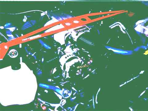

Keep dreaming. My opinion with that 305 TBI. Here is what you need......

Originally posted by Z28DJP1987
drifter-x
peronaly i think that what he really needs is about 45 more cubic inches.
