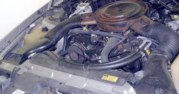

The factory designed an excellent "ram air" (there's really no such thing at highway speeds, it's just a marketing gimmick, what you really want is "cold air) system. It came on the L69 Z28s. I picks up cold outside air from above the headlights.

RB83L69....is that your original L69?

Such as it is, yes. The pic is about 2 or 3 months old.

did any 'birds come with the L69, and if so, does anyone have any pics of the intake?

Yes. T/As were available with the L69, in the same years. I've never seen one with a dual snorkel but somebody says that their 85 had it, I've only seen 83s and 84s that I can remember. Like most of the better air intake systems, the Camaro HO air cleaner won't fit under the anti-performance hoods of most Firebirds.

What kinda hood you got? Factory ram air for the "turbo bulge" (82-84 t/a & formula) came on both the crossfire and l69 t/as in 82-84. Might be kinda hard to get ahold of though...

Actually, the bulge hood was on the 82-82 Crossfire cars, mid 82-84 LG4 cars, and late 83-84 L69 cars. For 85, the Trans Am had the dual snorkel air cleaner. For the 83-84 L69 cars, they used the same single snorkel air cleaner as the 82-84 LG4. Both used the functional air induction assembly on the hood. The hood was brought back in 87 for use on the Formula cars and was used till 92....the only difference being a block-off plate instead of a screen and induction assembly.
