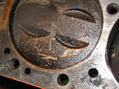

pulled one of the 462's Today...ick!
Tell me what you see.....I only got the drivers side off today...lots of carbon...Remember the valve seals were shot shot shot...the cylinder walls look great. no scoring or scratches..the # 5 piston has a burr ,sharp point, spot at about 6 o clock...what the heck is it???? Cause for concern? The cylinder walls look great ...Give it your best guess...tell me what you see in these pics. Please..

Casting imperfection on the piston or a piece of hard carbon build-up. Actually those pistons look good, not too much carbon and still see almost all of the metal surface on them.

Looks like a typical old motor with head gaskets that didn't seal... look at the brown stains in the narrow place between #3 & #5, and the very front end of the head, around #1. That's combustion leakage.
The #3-#5 leak is typical of over-torquing, because of the way that makes the head flex upwards in between the bolt holes.
Looks like there were plenty of crispies built all up inside that motor too.
I would strongly recommend grinding the edges of that rough place in that piston smooth if possible.

Not to hop on the bandwagon and overload it, but it appears that RB is right (like we'd think otherwise?). The top of the web area between #5 and #5 seems to have been leaking combustion. This might be the result of overtorque, or natural casting warpage. Better check the deck and head surfaces.
It also looks as if you may have had poor coolant sealing aroud the rear hole at #7.
Those are camel-humps?
As for the marks in the piston tops, bring each piston to TDC and clean the tops as best you can. I like to use a wire cup wheel in a die grinder or drill to remove carbon. Once they are cleaned, you may discover that the marks are position, indexing, or oversize markers, casting imperfections, or damage form carbon particles (the latter being the least likely).

great stuff here..from the best, I love this board...Yes, They certainly had some troubles...yes Vader they are 462 camel humps...now the are my practice heads for home porting!!! I am replacing them with some 416's.... I could never keep plugs in those heads either...tried all kinds ,,they would loosen up everytime..im talking in under 500mi.
The guys that built this motor were some real backwoods kind of Iowa Hillbilly's...anything is possible...
Like I said ...the bottom end sounded real good. Good oil pressure..and the motor ran a cool 180* always......My future plans are Running the 327 this summer...buying a 350 shortblock...then do some major part swapping..into a 355 next winter..Everything I have upgraded will work just as well or better on a 350..correct me if I'm wrong...

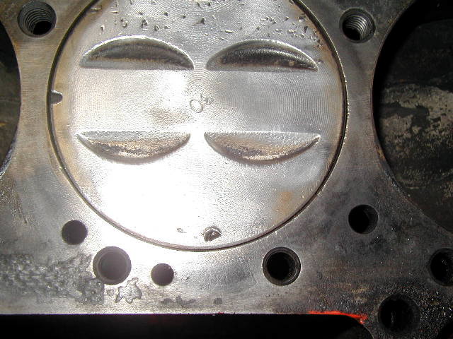

I got the rest of the motor tore down today...not looking good..the piston with the scar on it..is just that . after cleaning it up a bit I can see something traveled throgh that cylinder...there is a scar on the cylinder wall I can hook my nail on. Both of the old heads were warped enough to see it with a straight edge...the deck looked ok...I pulled the cam...the front bearing is all scored up..so I'm sure the rest dont look too good...all of the other pistons and cylinder walls look great...Im at a delima right now..I called a machine shop some friends use..He said he could sleeve the bad cylinder then bore it to size....install new cam bearings and reassemble the short block..all for around $200..seems cheap enough..assuming they dont find any other problems....here are a couple more pics...oh yeah, when I took the pan off, all I found was these plastic like pieces..they arent affected by a magnet...what could they be? And any opinions on the machine work...feeling kinda low right now.. The plastic ? parts

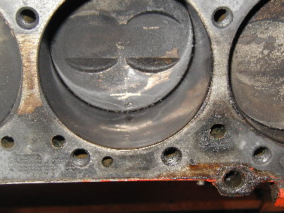

piston #5 cylinder wall

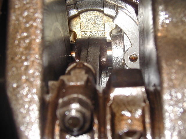

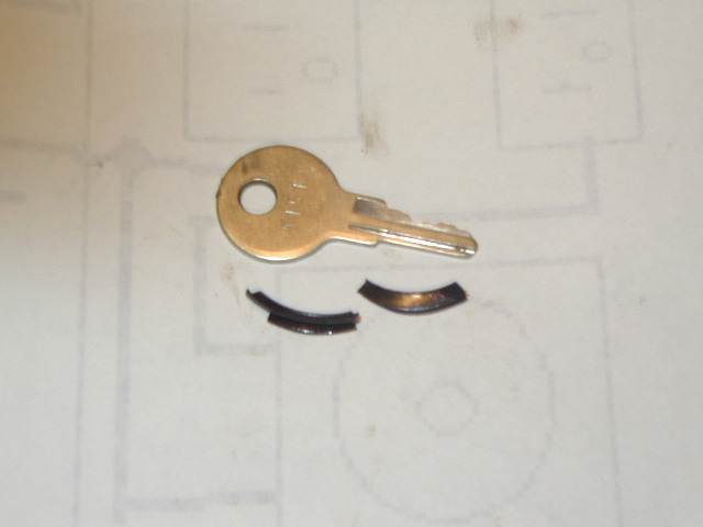

bearing

here is the rest of #5

Those pieces look copper, rather like crank thrust bearing, to me....
The pistons look forged to me, TRWs specifically, except that they don't have the part # stamped on their face like TRWs always do. Beyond that, I can't tell much about them. Maybe when you get them out you can tell more. Cast & forged pistons look very different; usually the top of a cast piston looks very cast (just like the outside of a head or something), while a forged one is machined on top like those.
The damage to the piston may have occurred before the motor was put together.

thought i already posted this but its not there......I just put a lighter to the mystery pieces and the caught fire and melted...Heavy sigh of relief.....

Old distributor O-ring? It looks like it would be larger diameter than that though.
Good guess mine was gone from the distibutor...

I want to use the same pistons, Rods, and crank...everything else will be new..The only cylinder I am concerned about is the #5. all the rest look really good...I'll know more next week!
