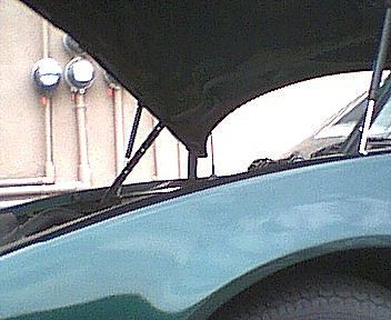

Here is a picture of the base
Attached Thumbnails Installing new engine into 3rd gen, TorkMaster be OK? Few other ?'s-a8965.jpg

There is plenty of clearance when you have the right aircleaner base. The K&N base is not the same as the Old GM base.
It fits (with room to spare) and works great.
And much cleaper than a new hood and paint job.
Good enough for L-88 427's from the 60's ( about 550hp with headers) good enough for your small block.
Attached Thumbnails Installing new engine into 3rd gen, TorkMaster be OK? Few other ?'s-rpm2a.jpg
