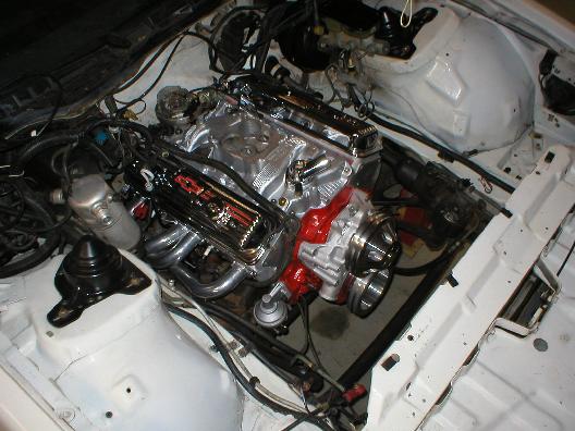

Getting things back together slowly

niiiice:rockon: what mods?

eeh...their just worked over D-ports sittin atop a Comp268 cammed 305......now if I could find the time to bolt'em down

lookin good, keep me up on the progress, im sittiin on 3 305 roller motors ,....pointers would be nice, ive never beefed up a 305 before, might be fun

is the comp cams 268 cam a roller cam or flat tappet? buecz i plan on puttin a 262 cam in my 305 and was woundering how a 268 would act in a 305.

My Comp268 is the High Energy series.....running it with 1.6 rockers. Not sure what the Hp will be. Put an ARP head bolt kit on it today and it only called for 60lbs of torque. I went about 70 with my old needle torque wrench. That's what the Gm guys recommended that sold me the l98 vette head gaskets..

Why the 1.6s? Why not go with 1.5s? I would think the lifters could handle a bigger profile than the extra load on the rockers. Also if you go with the bigger cam/1.5 you could always goto 1.6 later.

Well, had them from way back but never got around to putting them on the stock heads/cam.....Is it overkill or something?

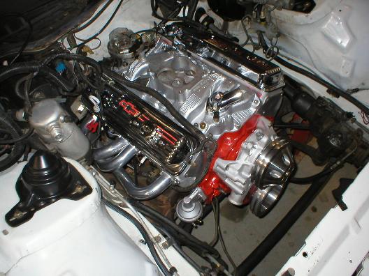

First, your engine looks great man; I hope it runs as good as it looks. Second; I have 2 questions: 1:Why stay with a 305 2:why not clean the engine bay to match the gnarly engine?

ok 87daddyformula.... Got to think'in on the clean engine bay idea and you're right.. Thought I'd better take care of that one before I add anything else....Had planned to take care of the cleaning later ,but figured it would be easier to get to things now.... I chose the 305 because it was the stock low mileage block with exceptional service records. Was always impressed with the clean runnin oil too... I know it's not much for severe duty, but this motor top-end build has sure been a good experience for when I go to droppin in a 383 or 4XX later on... And here's some clean engine bay pics to add.....

Thats awesome man...I can't believe how much more that compliments the engine...Was the engine build straight forward enough for a first time builder like myself to do?
