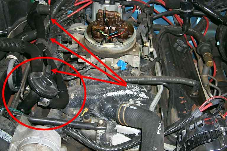

I have attached a picture...arrows point to the vaccum line circled is the heater valve diverter.
Ps. Doesn't matter if it is a tbi or tpi engine
