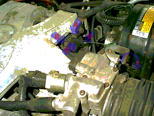

Sory Zippy but i have to disagree. I personally use the TV cable to adjust my shift points and know from a hands on "track on" experience. This section is taking directly from thirdgen.org. Read the article named "Adjusting the TV Detent Cable" from my previous reply......or better yet here it is.....
Adjusting your TV detent cable:
for 1973 and later TH-350 and TH-700R4 auto trannys
By Scoob ( scoob8000@yahoo.com )
Overview:
The TV (Throttle Valve) detent cable controls line pressure, shift points, part throttle downshifts and detent downshifts. Over time this cable can come out of adjustmant and cause improper shifting, which is not only annoying but can prove to be harmful to the transmission. In this article I will explain in brief how to adjust this yourself in about 5-10 minutes.
Notes:
This picture is on a 2.8l V6, the procedure is the same for other engines, although the TV detent assembly will be in a different location, on some models such as the LG4 application, you may need to remove the air cleaner.
Difficulty:
On the usual scale this one is a 1.
Tools:
Two hands and a brain. :P
Directions:
Once the hood is open and the engine cool, locate the TV detent assembly. Push in on the metal tang (B), and slide cable assembly (D) all the way back so its flush with the mounting tab (C), and release metal tang (B). Grab ahold of throttle lever (E) and move in direction of arrow all the way to WOT, you should hear a series of clicks. Release and you're all done..
Old Oct 11, 2003 | 12:55 AM
25THRSS's Avatar
Posts: 5,740
From: Glen Allen, VA
yes that article is correct, but it shows you how to correctly set it back to factory specs, not how to adjust the shift points. I suggest you go put your's back how it is supposed to be or else your tranny will be taking a crap very soon.

can someone take a pic of their tv cable in their 5.7L for me? i dont have a clue what im doing here, and that pic really doesn't help me much... if i had a clearer picture (especially an engine like mine), and i knew where the F*CK the metal tang is they're talking about, i'd probably get this crap out of the way already, lmao

JESUS H CHRIST. DO NOT EVER ADJUST YOUR SHIFT POINTS USING THE TV CABLE.
Well, unless you want to fry your tranny in short order.
Bri, you should really make sure you know what you are talking about before you go around giving incorrect and VERY damaging advice like that.
