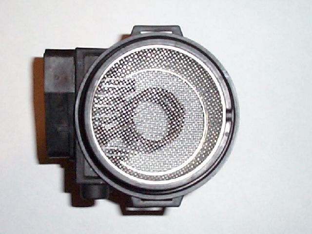

Hey Vader, You have that pic of the thick filmed MAF?
Ron,
The MAF sensor was the same on Chevrolet TPI engines from 1986 through 1989 models. The early 1985 models used a digital output Delco MAF, and the rest used an analog output Bosch MAF. Any year or engine from '86 through '89 uses the same MAF sensor.
Of course, I have a photo:

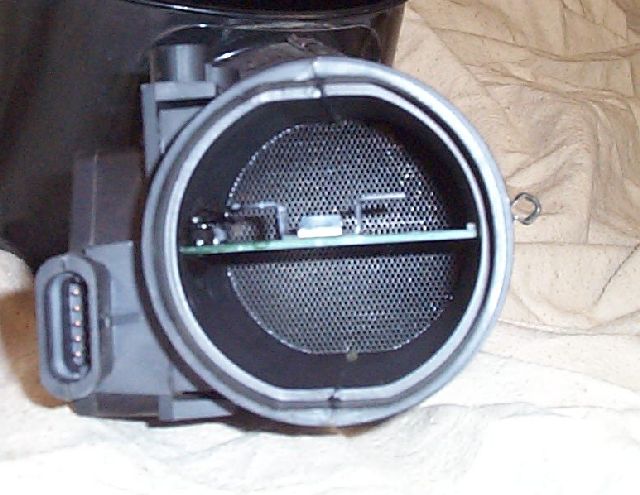

Ron,
You've pro'lly already got one of these:

I'm sure it's been said before, don't remove the screen on that thick filmed MAF. I did that before I found this site and my car ran horrible. It had horrible driveability and my ses light kept coming on and going off (depending on rpms) After e-mailing Borg Warner, I realized I would have to put the screen back in. Only problem is, the screen doesn't just pop in and out. I mangled it some to get it out. Anybody ever replaced these screens? (thick film type) My SES light doesn't come on anymore and the engine seems to run good (with mangled screen), but I'd like to put a new screen on if possible.

Ok, I must have missed something. What is the advantage of the thick film MAF? Is that just a replacement MAF made by Borg-Warner?

Greg,
This particular unit was made by Wells Mfg.
The screens are not necessarily there to keep dirt out of the MAF sensor.
The OEM Bosch MAF sensor has round wire screens mounted in metal rings which actually reduce the straight air flow across the sensor array. The more turbulent air behind the screen will flow through the sensor body more equally, so that the air flowing through the sampling tube will be a more accurate representation of the total air flowing through the sensor. There have been several notable instances of people carefully removing the screens without damaging the hot wire element, and then having MAF errors due to improper flow readings being reported to the ECM. At certain flow rates, the molecules of air tend to flow toward the outside of any curve, and can tend to flow around the sampling tube instead of equally through the MAF body if the screens are removed.
Additionally, these screens protect the fragile hot wire from debris and sonic wave shock caused by lean backfire and wide-open throttle "howl". These sonic pulses could significantly shorten the life of the platinum wire if not deflected.
The thick-film sensor eliminates the hot wire for temperature differential sensing (the way that a MAF measures air mass). The newer GM MAF sensors (LT1/4, LS1, Vortec) use a thick film instead of a hot wire sensor. They also use the flat metal matrix instead of a round wire screen at the inlet side of the sensor body. The Wells unit is of the same design.
The particular sensor in the photo has an inside diameter of 73mm at its smallest point and 78mm at its largest. The stock design (and remanufactured) Bosch hot wire MAF has an I.D. of 70mm.
Other than that, I found the thick film sensor only to be slightly faster than the hot wire in sensing changes in air mass moving through the housing. I guess if you don't mind a little extra hesitation at throttle tip-in and having a fragile, restrictive, and failure-prone sensor on your car, there are no advantages to the thick-film design.
GM must have seen the same things in specifying a different design for the newer engines in 1992.
