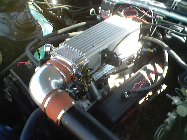

Originally posted by mrgoodwrench
Thx everybody, kinda disapointed but What is HSR?
Try www.stealthram.com. See my pic. I have HSR.
