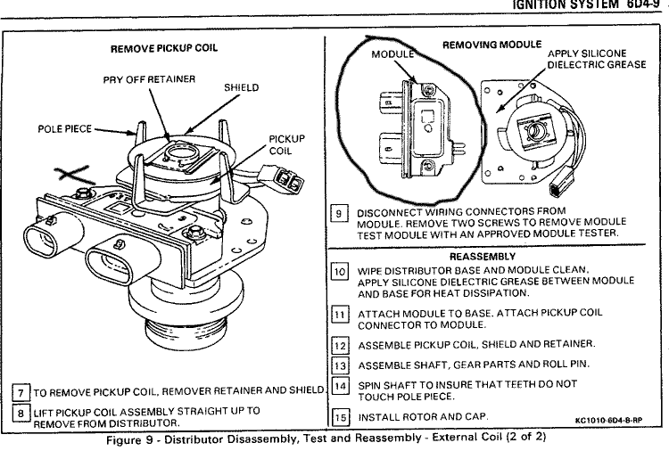

The ignition module is located inside the distributor underneath the pick-up coil and attached to the base by two screws.
