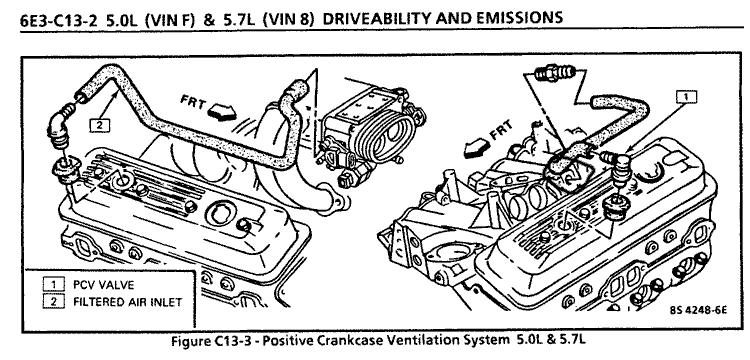

On a 91 Camaro I just bought...with a 5.7
There is a chrome breather on the passenger-side valve cover and a PCV hooked up on the front part of the driver side valve cover. There is ALSO on the driver side valve cover, a rubber hose on the back part of the valve cover that is about 9" long...it doesn't connect to anything and is open.
The previous owner said it is a breather too.
It occured to me that this is a big vacuum leak, right? If there is a PCV on the same valve cover as a breather, that is a vacuum leak and could be a source of oil consumption?
Does this make sense?

There should only be two opening in the valve cover on the driver side. One for the PCV valve which is ported to the intake manifold and one for the oil servicing cap. Are you sure that 9" hose doesn't come off the back of the plenum and go to the power booster on the firewall.

Adam,
Is there a oil servicing cap on that valve cover? If it doesn't, it sounds like they took a spare valve cover from the passenger side and modified it. As far as a vacuum leak being there, yes definitely. That is supposed to be a closed system and any openings in it allow more air into the system.

The metered air is supposed to come THROUGH the engine and from the breather, so the way it is set up now, it SHOULD be a big vacuum leak.
