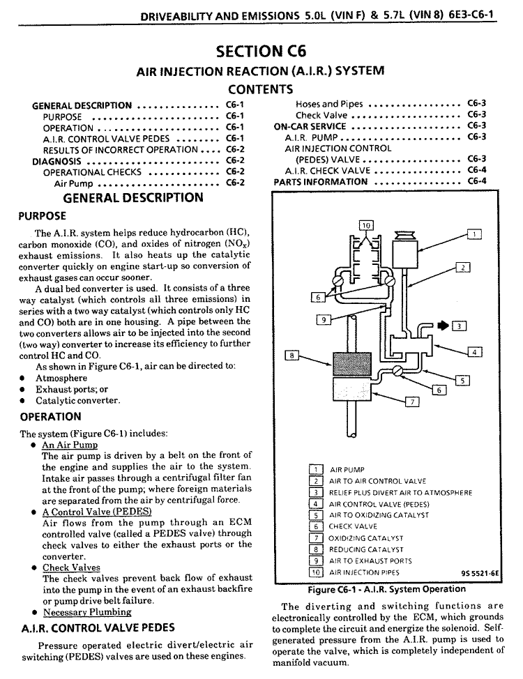

If it's the line I'm thinking of, it is the line that went from the Air Injection Reaction (A.I.R.) tubes on the exhaust manifold to the catalytic converter. See pictures.

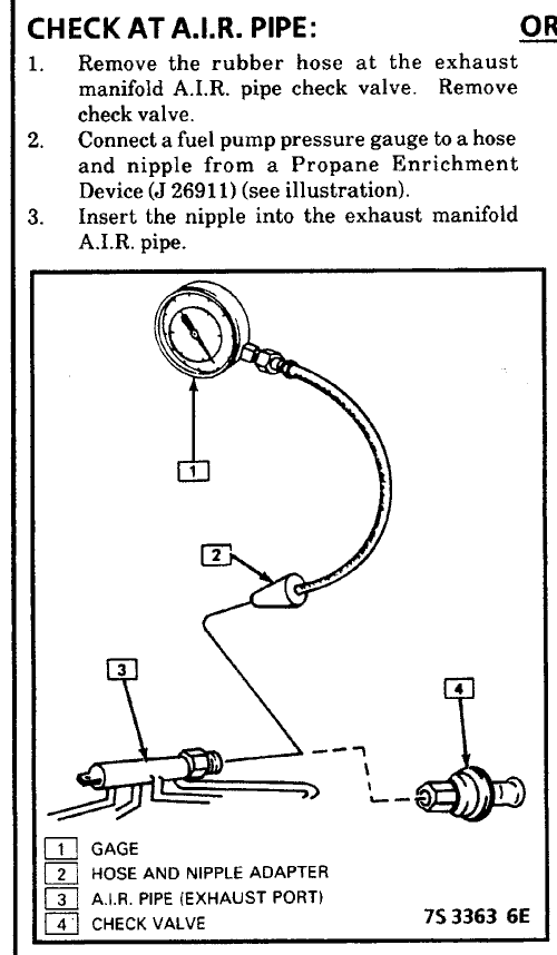

page 2

I agree with five7kid, it could also go to the EGR solenoid if equipped with it.
