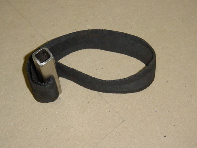

I have a strap wrench on a square bar that you put on a 1/2" drive ratchet. The strap turns around the bar as you turn the ratchet, tightening the grip on the filter body. I have yet to find a filter it wouldn't remove.
