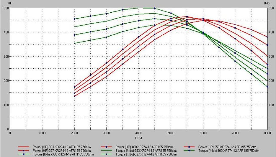

Here's a DD graph that shows the power curves of the 327, 350, 383, and 400.
All using the XR-274 cam, and 195cc heads.
https://www.thirdgen.org/techbb2/att...postid=2072263
As has been mentioned earlier, and I'll agree with. If a builder is starting with a clean slate, more displacement seems to make the most sense.
