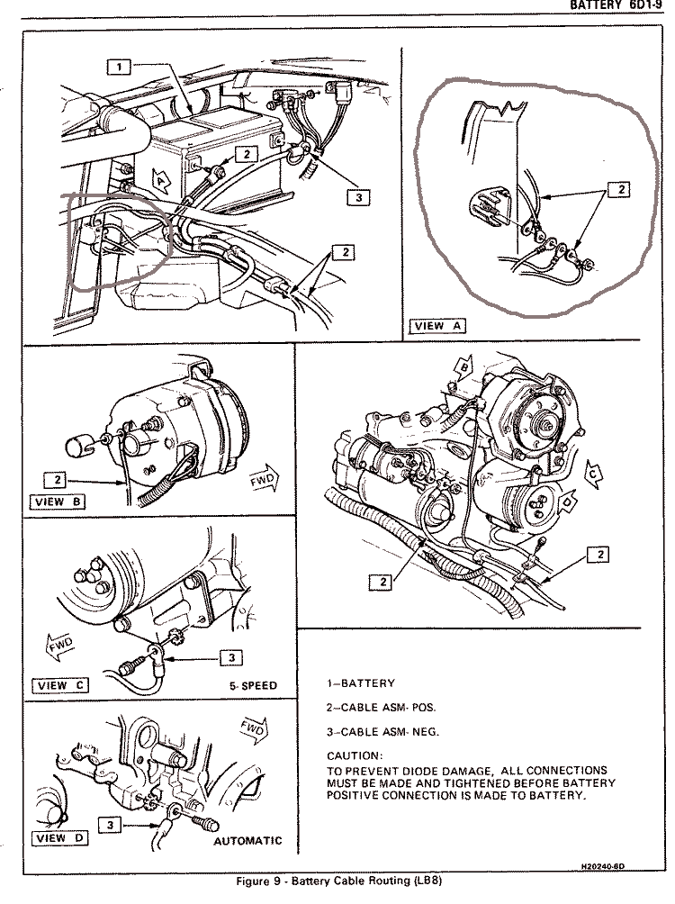

I am unable to view the attachment you have but what you are describing sounds like a power distribution junction block that was on some models. Does it look like the items circled here.
Yeah... every V6 I've seen has these including my own 91 RS. Not sure about the B4C though.
