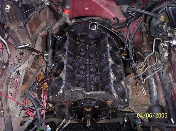

It curves around it? Is this it? Please tell me it is, i took that cap off thinking it would get in the way of the new manifold

That would be it sir. Go to a parts store, and find one that is smaller or, find a angled fitting then cap it off. Ill try to find a pic for ya.
Just reread what you typed, it should clear the intake but if it dont, do the above.
Kevin

firebird45331's Avatar
Joined: May 2005
Posts: 500
From: greenville, OH
Car: 86 Firebird, 2002 Monte Carlo, 91 v
don't have my glasses on, but that's about where it would be

I still have the piece that i took out. Ill just put it back in.
Kevin, here is what my engine looks like now:
Attached Thumbnails Finally got engine back togegher, need help getting it to start-new-engine.jpg

Looks a 1000 times better, and will perform just as well.
