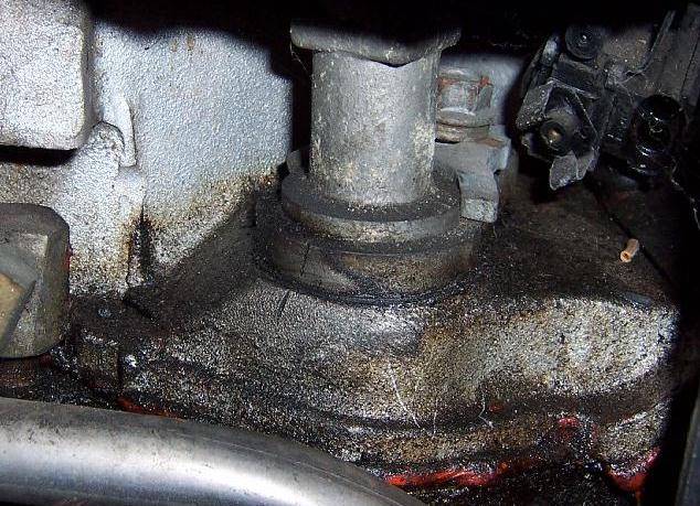

GM's hidden timing marks. They are in the back so you have to have a mirror to see them (handy). If you still have the factory intake and distributor they should be there. This is an '88 TPI motor.

Supervisor42
I found the factory marks, that is really awesome, I was lining it up close to that mark and trying to rotate and it just seems like it won't go, it seems if the distributor was assembled wrong it would still slide in like it is supposed to, after all the work of a head gasket this is what is stopping me.
