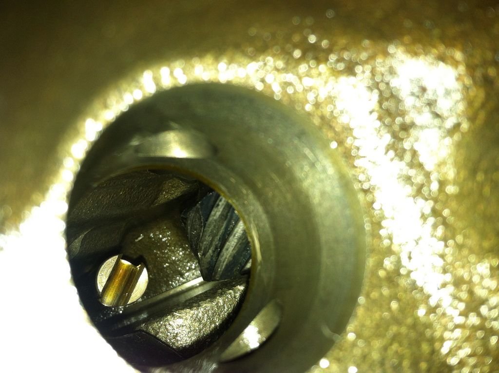

Pics diagram of mod would be very helpful. Where can I get a picture or diagram.

If you're not a bot, LOOK AT your distributor. There are 2 raised areas down near the gear. Those places seal off (somewhat) the passage in the block that feed lifter passages. All ya gotta do is cut a small groove or whatever (emphasis on "small") in one of them to oil something. Not hard to wrap your brain around. Kind of a no-brainer. Speaking strictly as someone who lacks a brain, so, no wrapping for me, butt since this is a no-brainer, it's right up my alley. Much tougher for someone stuuupid like me than for someone [forrestgump]smarrrrrt[/forrestgump] like you. Butt hay, I get by, in spite of myself.
If you cut a groove in the lower one, it oils the gear. Not hard to see where to put the groove for best oiling of the gear; kinda like, LOOK AT the dist, LOOK AT the block, LOOK AT the gears. Put your groove where it squirts the oil on the gears just before they mesh, taking into account of course the variation that might occur as a result of adjusting the "timing". Pretty ... self-evident. Even I, lacking a brain, can figure that out. Harrrrrrdddddd as it is, it's not insurmountable.
Not sure of any benefit to grooving the upper one.

Here are your pics.
