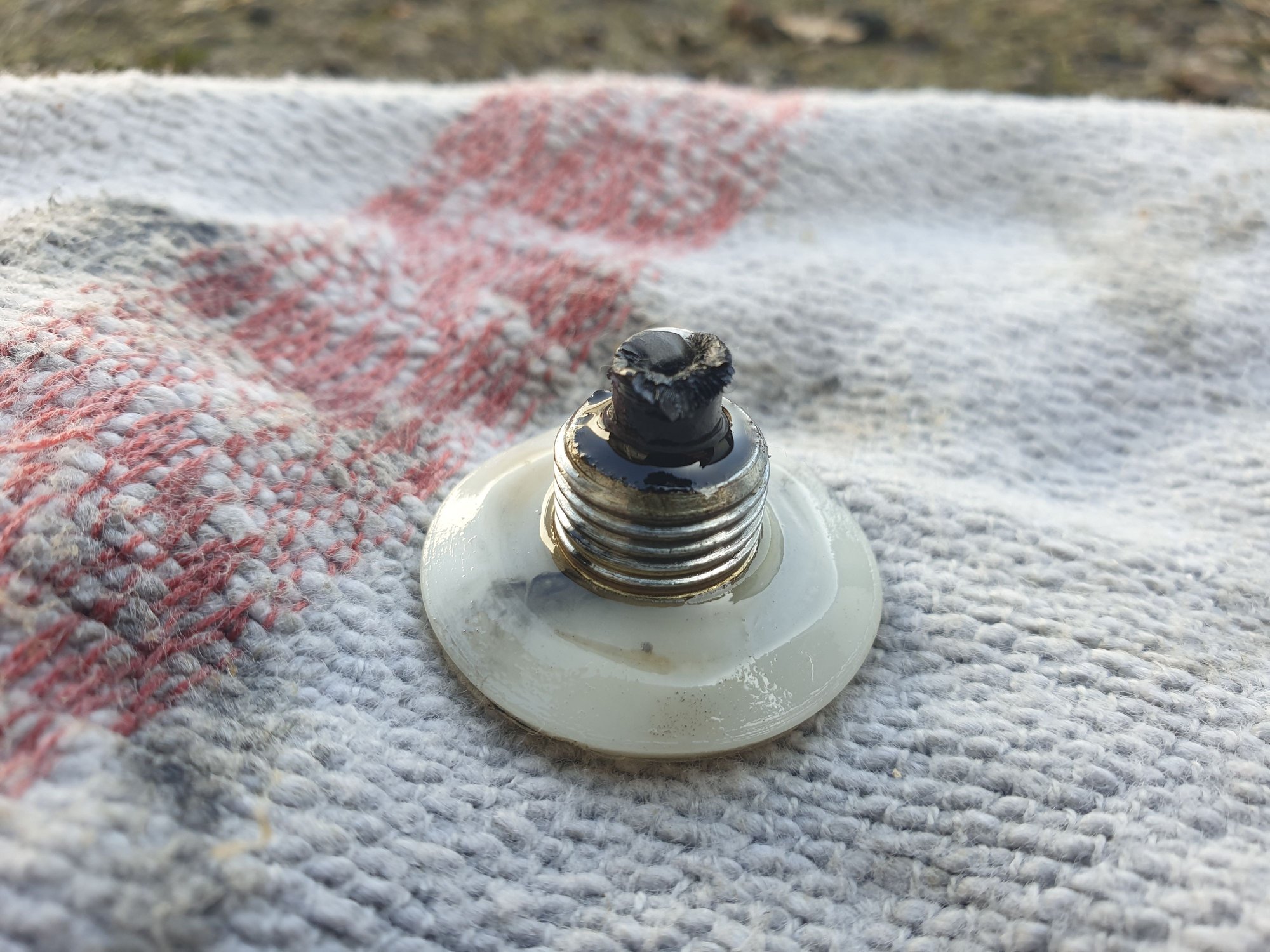

Ok guys, I have a REAL strange problem here... I heard a strange rasping sound from my engine today. Located it from the distributor. Pulled off the cap and noticed massive play in the upper bearing. Pulled the distributor out and yep... upper bearing nearly total out of round. Distributor shaft has visible signs of waer. How is that possible?
Also, the distributor gear shows signs of wear from the camshaft gear.
Just for info, engine has been completely rebuilt 10 months ago, new crank, new cam, new chain, EVERYTHING is new except the distributor itself... I can't understand what has happened here... please don't tell me something is wrong with my engine or the cam gear... anyone ever struggled with that?

Well I would say you aren't getting sufficient oil to the distributor/camshaft gears. The shaft should be pulling oil up that helical groove, but based on the gear wear there isn't much oil there for it to pull from.... It is often recommended that the distributor housing be modified with a groove to allow additional lubrication directly on the gears.....
http://garage.grumpysperformance.com...ear-wear.1701/
There is almost certainly going to be some wear to the cam gear also so you should inspect that at the very least.
What's your oil pressure like?

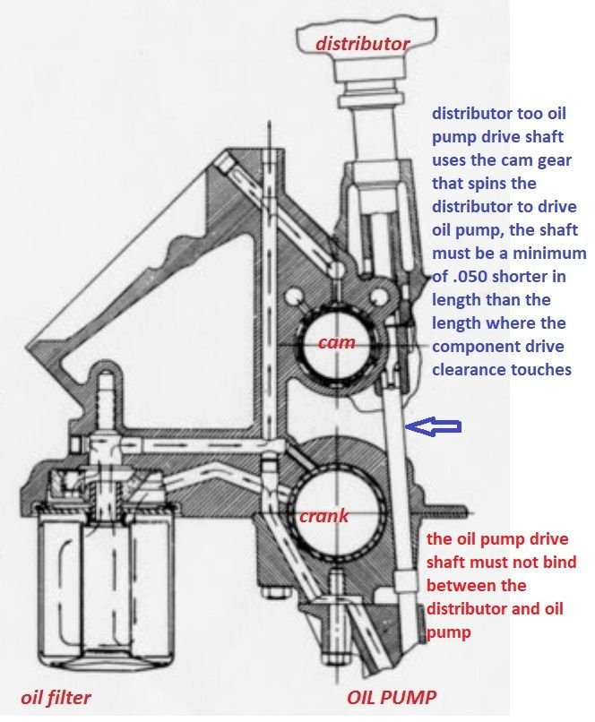

I'm looking for a picture that shows where to drill 2 holes in the lower distributor housing to lubricate the shaft.
You also need to verify that you are not putting pressure on the oil pump drive when you clamp the distributor down, as RBob said above.
MSD distributors have 1 hole as shown.

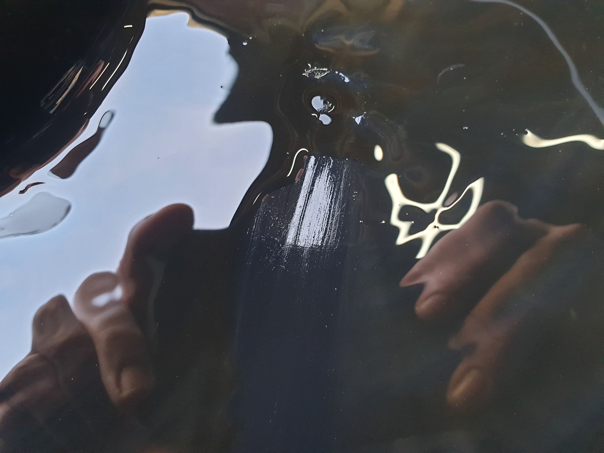

i also drained the oil today into a clean pan. I seem to have a greyish haze / veil / mist (don't know the correct english word) in the oil. But no visible or big metal flakes. I also have a magnetic drain plug, on the metal tip were very very fine dark / grey flakes. Is it possible that this is from the piston rings and the defective distributor gear? Oil pressure was always fine as I mentioned before.
Engine has about 1500 mls since the rebuild and I changed oil three times since. Look at the pics I took today:
I am really unsure if this is ok or not... I also made a video of the oil, but I need to upload it to YouTube or something and embedd the link here.

New gear and old gear didn't like each other. I don't know much about Sealed Power cams other than I wouldn't have even thought to consider them. Oil and magnet look OK for an engine going through break in. But really that should be all done by a few hundred miles. Yes you will get some ring shedding, and some of that is clearly from that distributor gear.
Looks to me like new gear didn't like old gear and they didn't lap in well. No moly lube on them for break in? I'm not entirely sure about the shaft bushing situation but are you 100% sure that wasn't in-progress from before the rebuild? I would be checking the housing diameters of the old and new distributor to determine how much oil is going to leak by and then possibly, depending on dimensions, cut a groove for additional oiling.
I don't think you are totally hosed, but I would want to base my next move on the cam gear condition. In fact I would be suspect of the gear being cut wrong perhaps.... I would just swap the cam for a genuine GM piece or just put that factory cam back in. On a roller motor there is no need to match new lifters to a new cam. Nor is there really a good reason to replace a non-worn cam.

Strain that drain oil through a very fine paint strainer and see what you get. Post a picture.
