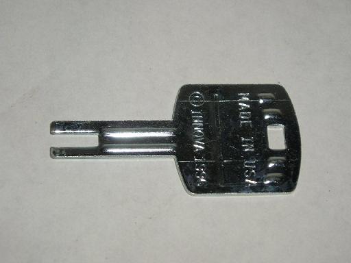

Old Sep 5, 2007 | 12:11 PM
Stephen's Avatar
iTrader: (12)
Posts: 12,212
Likes: 13
Car: 87 GTA
Engine: L98
Re: How do you read trouble codes?
The paper clip works just as well as the Autozone key. My local Autozone checked my codes (I didn't even have a paper clip or wire here) Then asked me if I wanted the key. Just gave it too me!

Old Sep 5, 2007 | 12:19 PM
85camaronetta's Avatar
Joined: Aug 2007
Posts: 56
From: Idaho
Car: 85 Camaro Berlinetta
Engine: 2.8l V6
Transmission: 5 spd
Huh? They told me I was s*** out of luck and would have to go to a dealer and get charged big bucks! Wow, I'm a little irritated now. I always have so many problems with autozone. No one there knows jack about anything. (At least not where I'm at) I go in and tell them what I want (part # and everything) and they ask me what vehicle its for, then they tell me "its not right" and "that didnt come on those". I'm lookin right at the part on my vehicle, dont tell me its not the right part!

Old Sep 5, 2007 | 03:28 PM
RS-Chevy-SS's Avatar
Joined: Oct 2006
Posts: 829
From: California
Car: 1989 Chevy Camaro RS
Engine: L30 TBI 5.0L Vortec
Axle/Gears: Stock
Wow, ok sorry, rant over.
Haha thats sux..but thats a preety kool key thing that stephen has got!!! Man i had a code flash on me about a week ago but i think it would have erased itself from the memory by now....

Old Sep 5, 2007 | 05:24 PM
Stephen's Avatar
iTrader: (12)
Posts: 12,212
Likes: 13
Car: 87 GTA
Engine: L98
Most Autozone employees ARE brain dead. Hunt around, find a good store, and stick with it. Be it Pep Boys, Oriellys, Shuckers, whatever. Find a parts store with competent employees, and keep going there
Next time I go by there, I'll ask if they know how to get more. It appears to just be stamped outta a sheet of aluminum, same thickness as your standard ignition/door key. In one shot, I bet they kick out a few hundred, in one 4'x8' sheet of aluminum!
Any Autozone should have those on hand. Chances are, the employee, but is too stupid to know what it is, what it fits.
