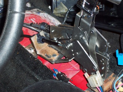

Okay, I was at the junk yard the other day, looking for a hood and came across a blue Camaro with Firebird wheels. I went over to the car and was checking out the wheels and then I noticed the spotless black interior. I looked through the interior and saw a B&M shifter and I was like BAM. I want it. I was able to unbolt everything I could but I want to know how to get it into my car. I pulled it from a 87 camaro 305 and want to put it in a 89 Firechicken 350. Trans should be the same correct? 700r4 not 200r4. I know I have to cut up the stock middle console but does anyone have pics or the original install instructions or something. Car still at the yard so I can pull more off of it if needed. Thanks ahead of time.

If you pulled everything out, brackets and all it will bolt right in.
Yes, you will have to cut the top plate, but the plate that comes with the shifter will cover it.
I believe if you look on B&M website they have the instructions to install.
Here are a couple pics one shows it installed, but I modified it to fit the stock shifter, And the other shows it installed, alittle dark, but these are all the pics I can find, I have a Hurst dual gate in there now.
Attached Thumbnails I hope I put this in the right place. LOL-mod-shifter.jpg   I hope I put this in the right place. LOL-100_0323.jpg
