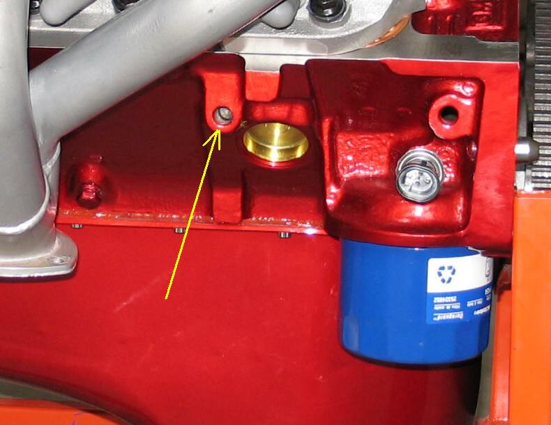

Hi,
Can you please let me know what is the size of this threaded?
I like to try installing there the knock sensor but the sensor has a thread of 1/8" NPT and did try to fit there a 1/8" NPT engine plug but doesn't fit.
I start to think that this thread is NOT NPT.

in your pic to the left of your arrow beind your hedder you will see a plug remove one of these and install your sensor there. mine is on the pass side.

Sorry but will not fit, it hits the headers and the other side too.

those two spots are really the only place to put one of the sensors. the location of your arrow will constantly set off the sensor every time the cylinder near it fires. I'm guessing that this is going into your kit car and your using the factory style harness?

That's one of the old clutch pivot ball holes.
Definitely NOT pipe thread.
If memory serves, it's 7/16"-14 thread.
Doesn't matter in the least that it's near a cylinder.

Thanks!
7/16 UNC has just a bit less diameter than the 1/8" Pipe thread so I will buy one of those and test it.

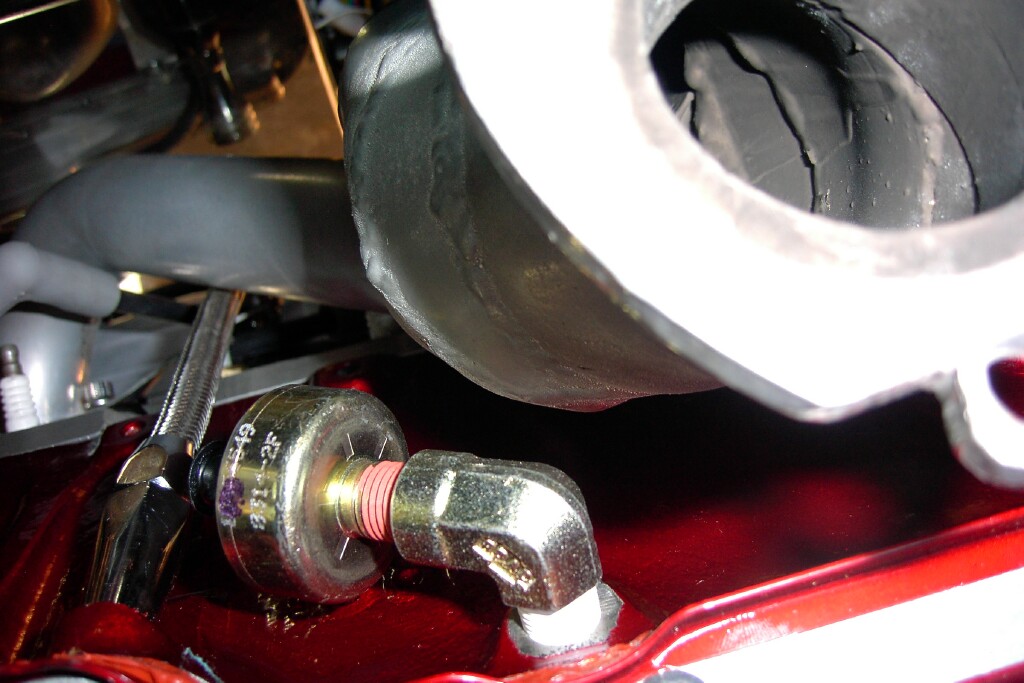

If you're running an electric fuel pump, you can drill and tap a 1/8" NPT hole in the fuel pump blockoff plate on the front, passenger side of the engine. I've heard of quite a few people relocating the knock sensor there with success.

I need to test first the actual location (see picture) and if the sensitive will be low I will change for the fuel pump block-off plate.
