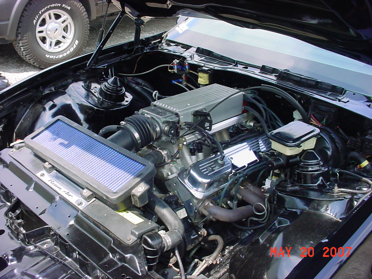

Cleaning up the engine bay..
http://www.fquick.com/garages/viewga...ewimg&id=92792
What can I remove to make it cleaner? Things like cruise control and stuff that I do not need

Dude I've whored out his picture more than anything. There are alot of things you can pull out to make it cleaner. it just depends on how far you want to go. Tell me and I mught be able to help. Yes my car is still TBI

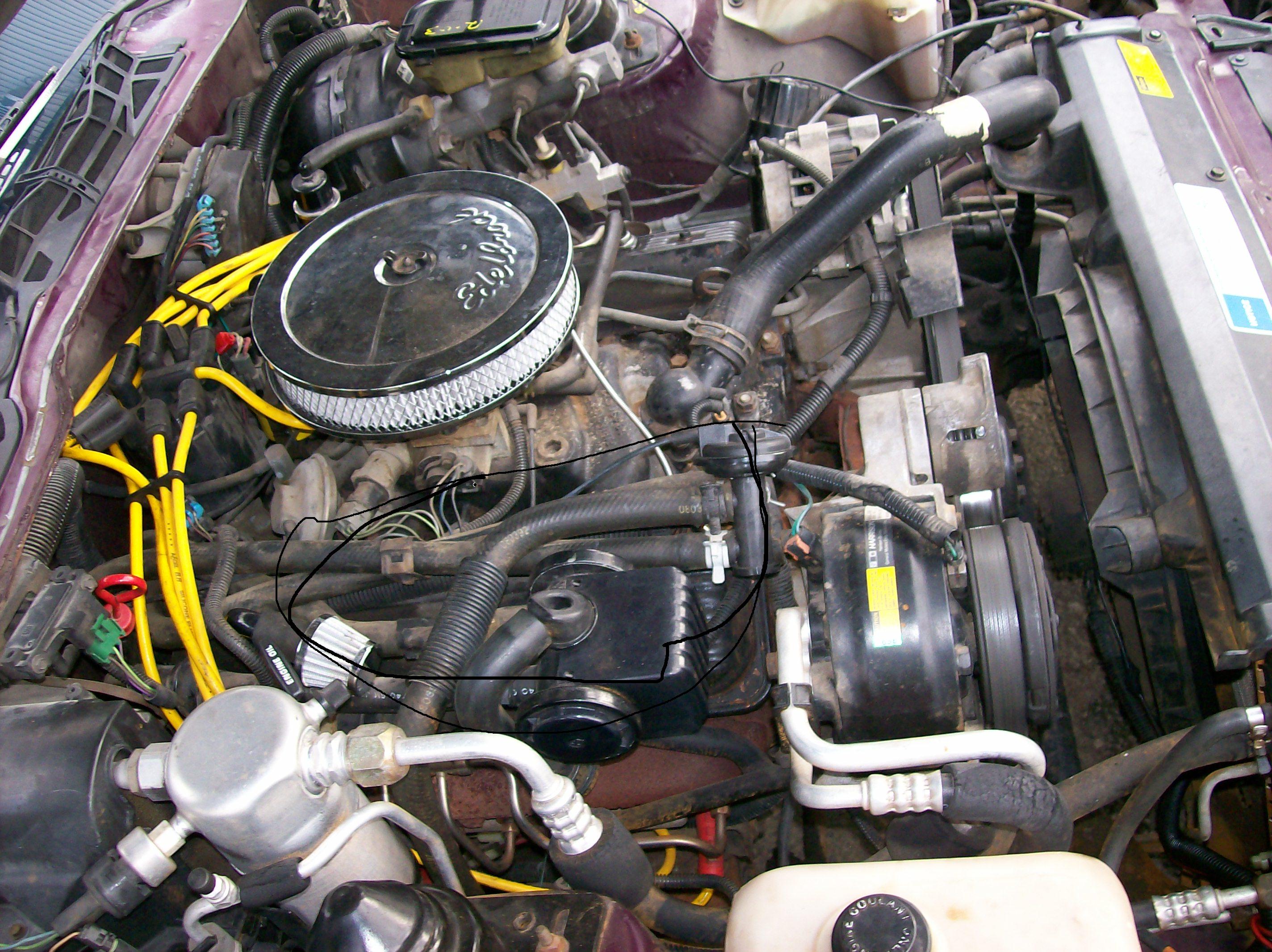

Is this your daily driver? If so you may not want to remove too much. I would relocate your alarm horn under the front of the car, the white wire you have going across the engine and any other random wires. Follow another wire going to that point or create your own line going across the firewall and then up to whatever it connects to.. Basic " L " format will always look clean and factory. Other then that looks like you need some simple green and a tooth brush, and get some new coolant and washer tanks.
If this is not a daily driver you can get rid of the A/C, heater control valve, heater box,and smog equipment (ck your local laws). You can also get rid of the washer fluid container, and replace the overflow tank with a catch can.

The white wire is actually for the aftermarket temp gauge that I didn't put in yet it's close lol. I don't want to use it as a daily driven car so I want to remove a lot. What can I do about all the EGR stuff?

What do I need to all take out for cruise control? What is all a part of it? If I take it out will my computer give me errors? Could I take out the A/C without taking out the heat?

Also look at all these hoses and that black box.. I don't want that there lol

That "black box" is the A.I.R. diverter valve. If they do a visual equipment inspection during your emissions test, it won't pass without it (unless, for whatever reason, they don't look for it in your area). If you remove it, you'll basically have to remove the A.I.R. system, which will make it less likely to pass a sniffer test (assuming they don't do visual under the hood).
What you circled looks more like the heater shut-off valve. You can eliminate that, as long as you don't mind your max AC not working quite as well as it might.
You can't take out the computer. It runs your TBI. To take out the cruise control, you would take out the cruise control and its hoses, wiring, and cable.
Ditto the previous alarm comment.
Personally, I'd remove the yellow spark plug wires - stand out too much.
And, I'd remove the rust. . .

Heres mine, still a bit of a work in progress. Out of the three cars ive owned, the third gen is the absolute worse/most difficult car for creating a visually pleasing engine bay. This is atleast 30 hours of work over the course of a year, SOLELY dedicated to cleaning up the engine bay. Heres a few tips i found work.
1) If your engine has any chrome, or is brightly coloured like mine, paint the engine bay black. Its hard to get the effect in the pix, because the black paint is reflecting. Its a semi gloss, that will turn flat over time. This makes the engine the point of focus.
2) Removal is probably the easiest way to clean up the engine bay, but sometimes you just cant remove EVERYTHING. So instead of looking at it as "removal", look at it as "relocating". Push wires out of the way as much as possible, and stick them behind stuff. Like most of my wires are hidden around the distributor, where you wouldnt normally be able to see. The huge loom of wires going OVER the brake booster, are now UNDER the brake booster, etc.. etc...
3) Spend the most time trying to have your intake manifold, and your valve covers exposed as much as possible. These two things are the main focus when a hood is opened, so if THEY are all you see completely, it makes it visually pleasing.
4) Hoses, (namingly heater hoses), should be as short as possible, and run parallel to other long straight objects. If you notice in my pics, they are running along side the valve covers, so they dont stick out like a sore thumb. I had to run the second heater hose to the driver's side of the car, and i used $0.80 90* fittings, to run it behind the carb, and make it look nice.
5) I did the same thing that i did in step #4 to the wires, running from the alternator. I put them in that plastic hose cover thing, and ran it along the valve cover. For some reason, when you run wires or hoses "parallel" to other fixed engine objects like the valve covers, it makes them hard to notice at a first glance.
I still have alot of work to do, but its coming along. Next i will probably see, which wires are going to where on the engine, and push the rest of them, INTO the interior compartment as much as possible.
Heres what i started with....
