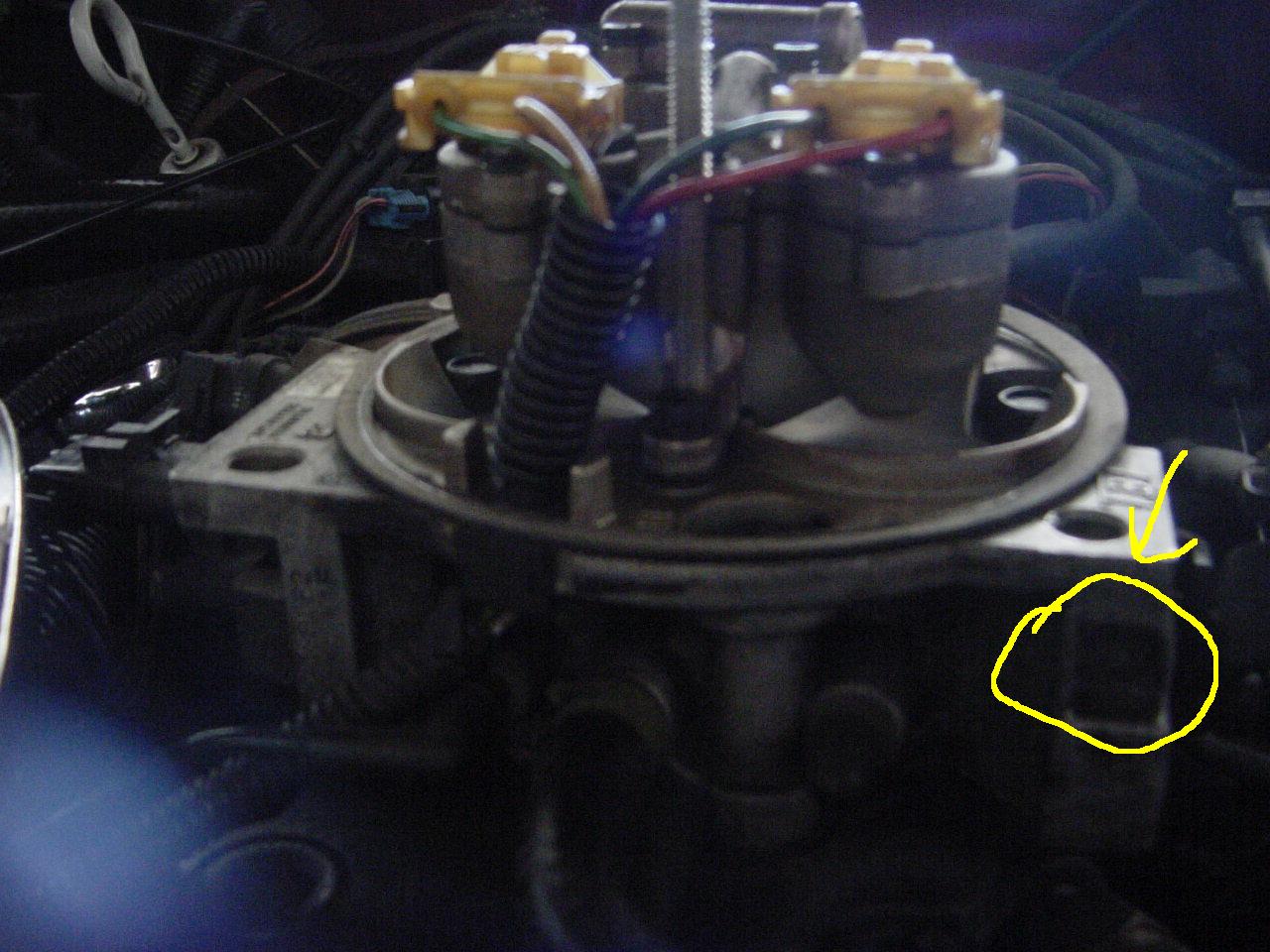

Ok hers some pics of mine show me the screw!

The screw is actually on the front of the TB, with this pic i circled the housing, there may be a punch in the hole4, just poke it with a screwdriver and it should come out to reveal the screw.

Re: How can i idel at 7 or 800 rpms!
in your pic its kinda dark, and i cant tell if you have the punch or not but looking from the pic, the punch and screw would be approx in this location

Once i posted the pics i went back out side and i seen what you were talking about. So i got it how i want it now thanks alot for your help. It sounds mean now for what it is. I got it warmed up and now at a stoplight or what ever it idels at 8 or 900 lol but sounds very good.
