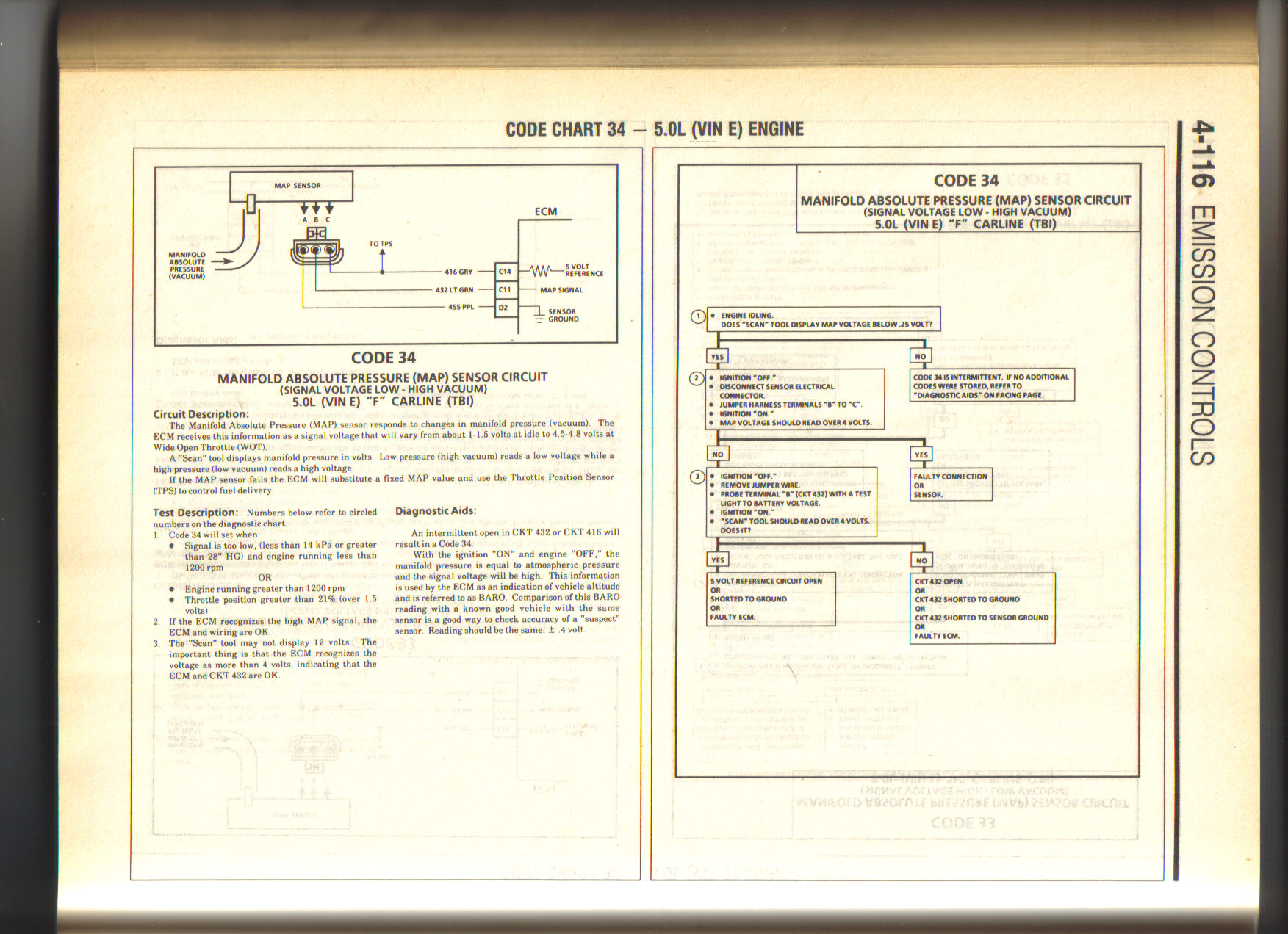

well, getting no where with car. today, after work, i cranked the car. it fired off first try. i let it sit there and idle, high idle. it didnt surge hardly any. several mins. of idling, it finally over heated, so i killed it. also throwing code 34, low voltage(high vacuum) at map sensor. i believe thats correct. i've yet to find the harness in the pic above so i can replace it so the fan will kick on. I called the dealership and they say the only thing they pull up in their computer is the coolant sensor, not a coolant fan switch. help the newbee out pls.

If your car is a vin code E, the color of the cooling fan switch wire is dark green/white according to my chiltons manual. I attached a pic for your code 34. Can be hard to find wires sometimes, especially when your looking for one wire and the connector could be missing or melted. If you have dual fans, the coolant temp sensor tells the ecm what the temp is and then the ecm will turn on the primary fan when its at a certain temp. The fan switch controls the secondary fan at a higher temp.
