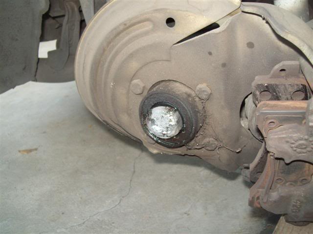

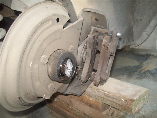

front rim lip is busted
the toe is drastically off too. havnt checked anything else.

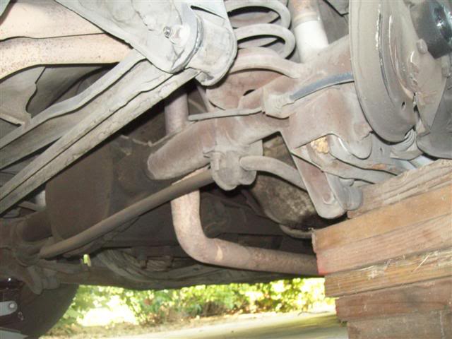

the rear pass axle shaft broke at the hub. and my y pipe got completely crushed
but other than that... no body damage at all..
engine started right up too
wut do you guys think needs to be replaced?!?
the brake caliper adapter plate is bent too.

Well the very fist thing ide do is get a copy of the factory manuals body measurment and check to make sure the frame is still strait. These unit body cars dont take hits well and when they do the impact travels through the whole car. So befor you spend big money fixing it make sure its worth fixing thats all. For the axle i wouldnt even bother trying to fix it as you can get a nice used replacement probablt for less that it would cost to repair that one. Maybe even a stronger BW 9 bolt unit. Next if the tow is off something probably got bent so definitely thoroughly inspect the front suspension.

i think you need the following..
1.axle passengers side
2. brake adapter plate thing.
3.brake caliper
4.rotor
5.need custom y pipes
6.new lug nuts
7.rim

The axle shaft sheered off.. Impressive. I wonder if the tube bent. Hows the control arms look?
Backing plate. Yep that too. Caliper. Rotor. Oh yeah.
What about the front? Toe is off huh? Bet it's messed up there.
I'd part the car out and get another one that didn't crash.

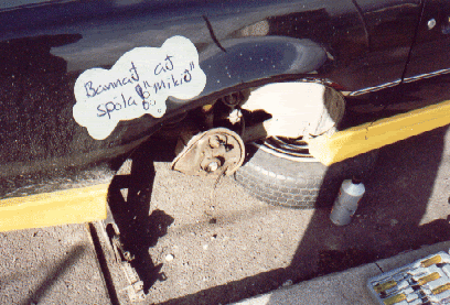

same happen to my brother ween he own my Trans am ,he decide to show off by make a u-turn only with the back wheels to much spin and hit the curb
photo be for digital camera ,it hard put the joke to English
(not allowed to spin the wheel "to much")

yup. looks just like mine.
did he just replace the axle or the whole rearend?!?
or is it now at C4C?

first only axle for doner trans am, but later mixd 4.11.1 axles and Differential from Astro Van into the trans am 10 bolt
