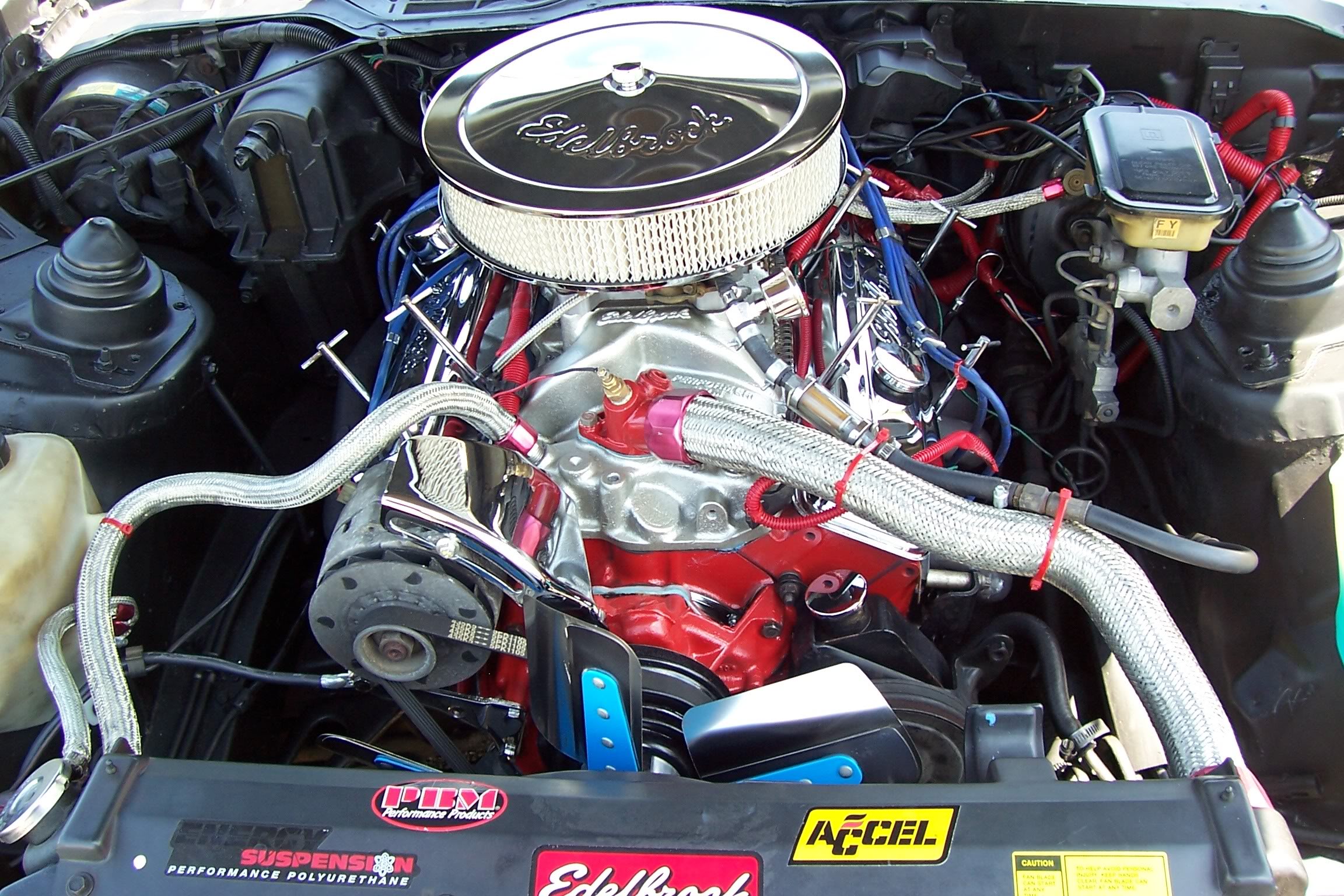

As I come to a stoplight (it's got a 700 trans) the engine bogs down HEAVILY and then dies. It fires right back up and runs great as long as I don't stop. Kinda like "It only hurts when I'm not sleeping." And thought's please? I can take pics of anything too. Thanks guys.
