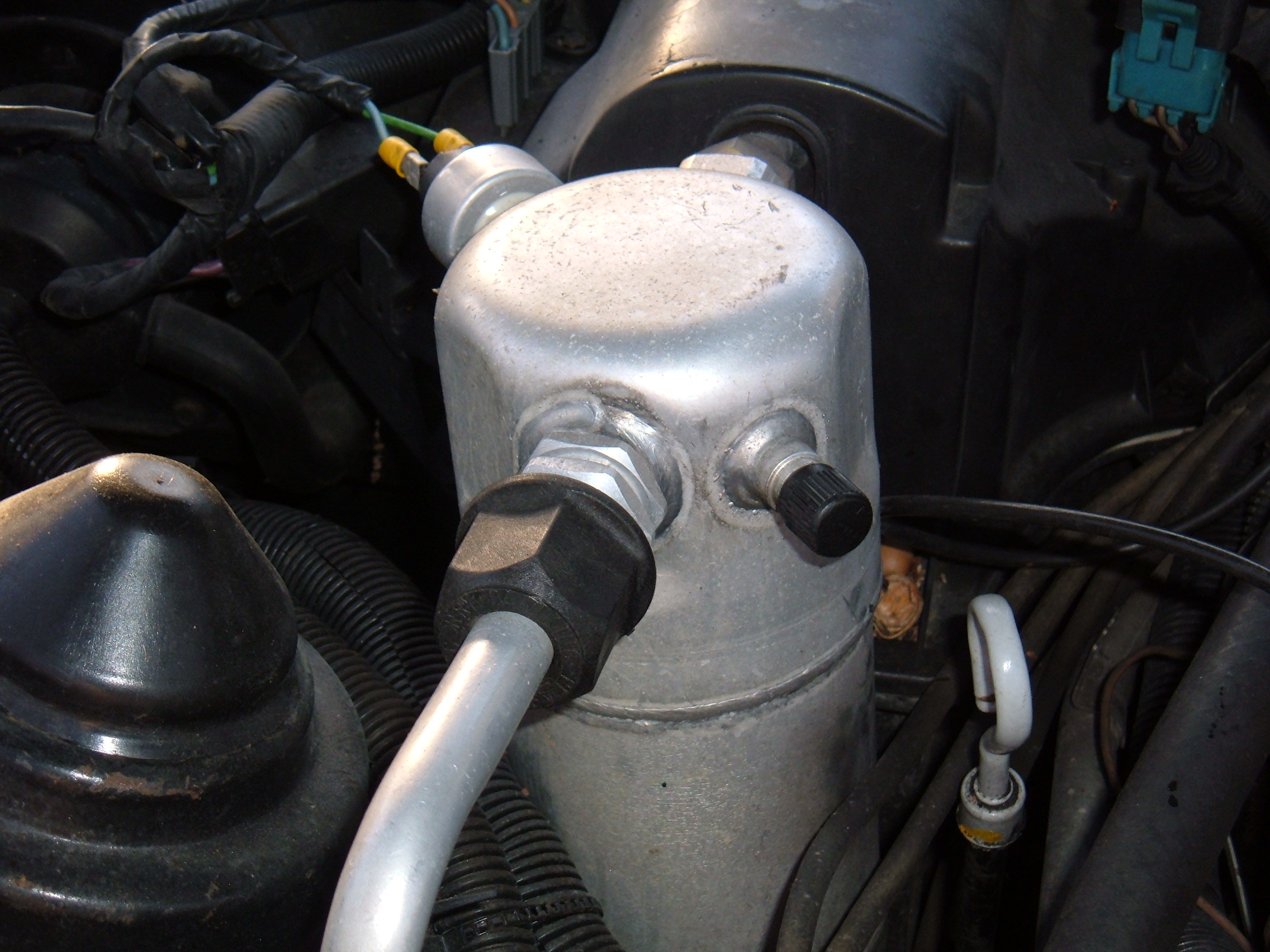

i am about to remove the ac from my car and i am wondering if there is a plug or something i can get to block off where the condenser is. i am inserting a pic of the condenser to be sure i am calling this object by the correct name lol thanks for all your help

That is not the condenser, that’s the accumulator.
You want a cap.
If I remember correctly, you need a ¾-16 NPT.

are you removing the accumulator completly?? if not then cap.
If so you can get a a/c delete plate made for the 1le cars. I have seen a few of them on ebay. You can also get the idler pulley that goes in place of the a/c pump as well.

can i just remove it without the delete kit? like cap behind it? also is the puller nesecary i dont have a serp drive i have V belts so i figured i could just remove it all and be good

i didnt even cap mine when i removed it. and you dont need a pulley if its a separate belt for the ac. heres one of the best pics of mine. i run a v-belt. and if thats whats on your ac then all you gotta do is just pull it.

If you think that sometime down the road you may get your A/C up and running again, or for resale value, cap off all your parts well
You do not want any excess air/moisture getting into the future re-usable parts
It will render them useless

Too bad I didn't catch this post before you removed your lines. 'The' sensitive piece in your system is the Receiver/Dryer, that big shiny can in your pic with the pressure switch on it. The can is full of dessicant and absorbes any moisture in your system.
It's OK though..if it's ruined they're not that much $. Consider replacing it new if you ever hook it all back up again.
