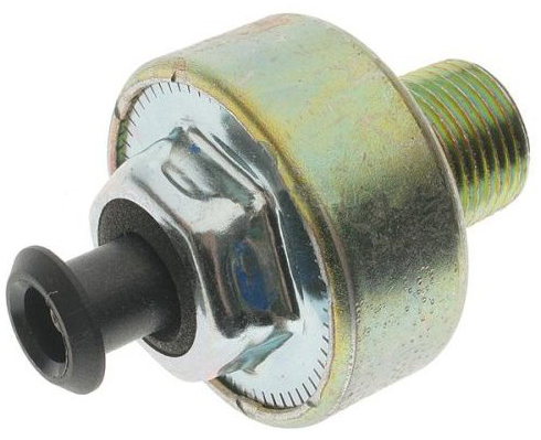

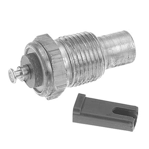

does the car have electric fans? which connector is it?
Attached Thumbnails Quick question- What is this sensor?-5640x1__51835_zoom.jpg   Quick question- What is this sensor?-g1852.jpg

The first one, nonmetal. Yes for electric fans

the fan switch should be in the top of the thermostat housing. i think there should also be a knock sensor in the block with the same connector.

fan switch

It's not a sensor, it's a thermal switch. It's for the radiator fan, turns it on when the coolant gets to 238 degrees F (or something like that) by providing a ground for the fan relay magnet circuit.
