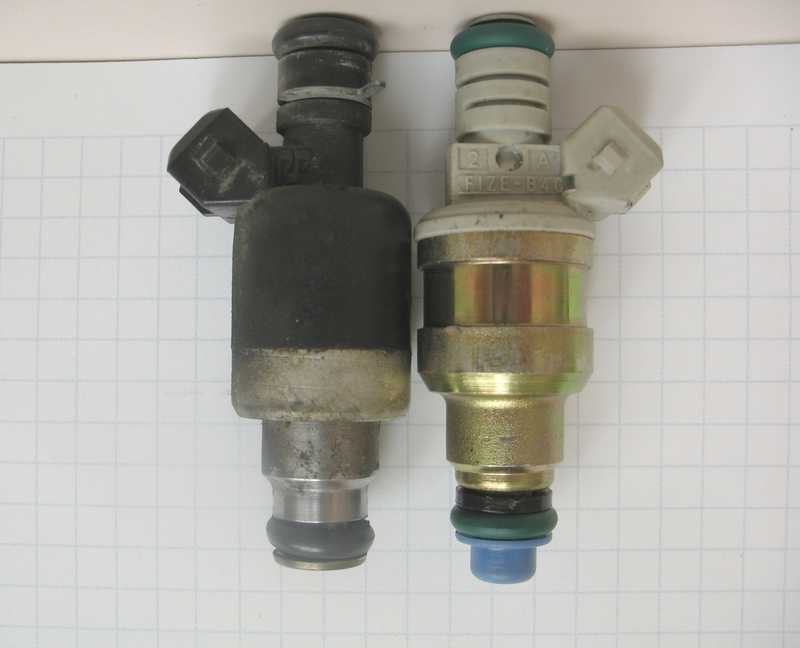

thanks RBob for all the info....how do i know if the injectors are Multec??
Theyre black, may be rusty, and are bulky. They look like this https://www.thirdgen.org/forums/tpi/...injectors.html

thanks for the pic & link....mine look different they look aluminum in color their not black which it sounds like thats a good thing & they dont have that green ring around them.

Unfortunately the picture in the above link isn't a Multec injector. Most likely a Rochester or maybe a Lucas. In the picture below the left injector is a Multec (used). With the right injector being a Bosch (Ford) injector (reconditioned). Picture is from a user on the V6 board that replaced the Multecs with the Bosch.
