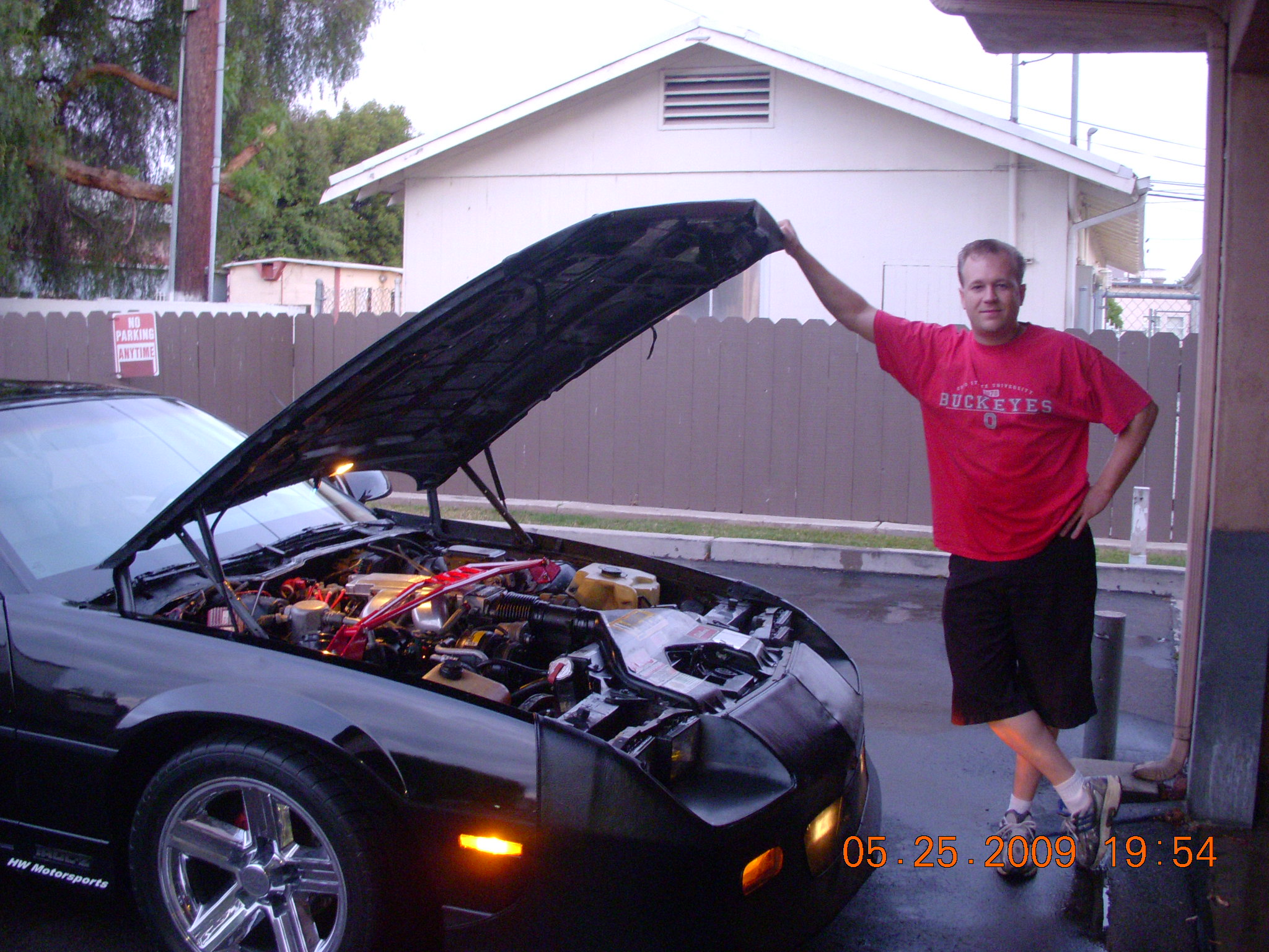

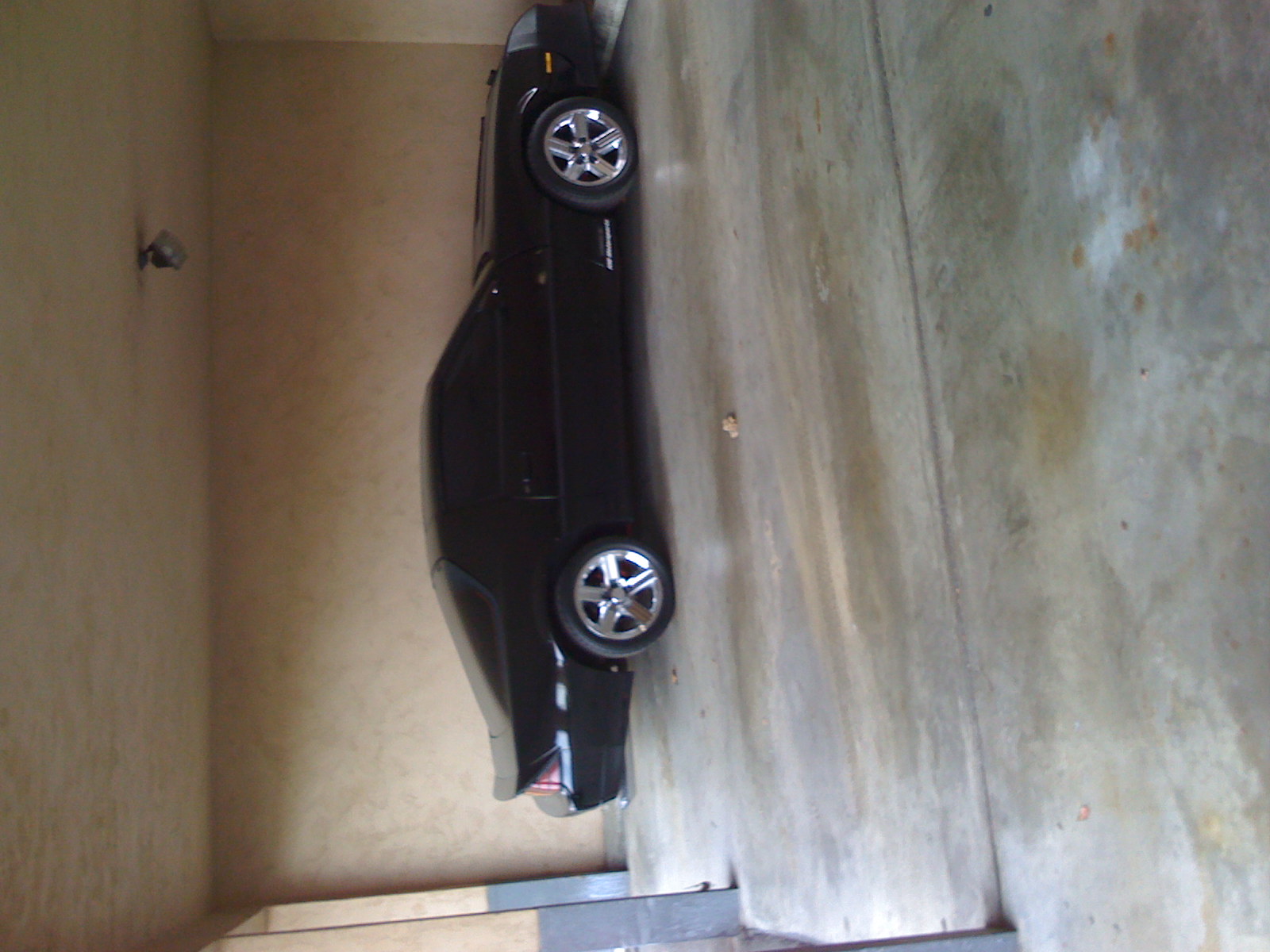

i'm getting a code 33 after driving a bit and when i get it the car start's missing and running rich,history on the car is--------------355 vortec cast iron heads----vortec intake base plate----slp runners---52mm throttle body---24lb accel injectors----adjustable fuel pressure reg*set @ 45 psi @wot,thermo master chip -----timing set@ 10 base--cam is a gm sbc hot cam lift is .525 .525 218/-228 edelbrock headers-3' all the way out msd everything ***new dizzy,cap n rotor,wires,plugs,and maf,what do you guy's think is the problem?
Attached Thumbnails i need help on fixing a code 33 on a 88 iroc 5.7-dscn0393.jpg   i need help on fixing a code 33 on a 88 iroc 5.7-picture-163.jpg   i need help on fixing a code 33 on a 88 iroc 5.7-picture-223.jpg

nice ride!
