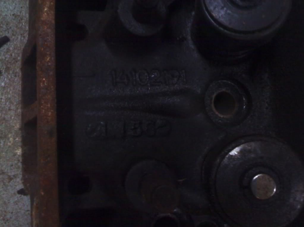

Heres one sent these look to be for centerbolt valvecovers and the other heads are not.
here is a picture of one set if you cant read the number its 14102191

This are swirl-port TBI truck heads, not a great start for a performance build.
