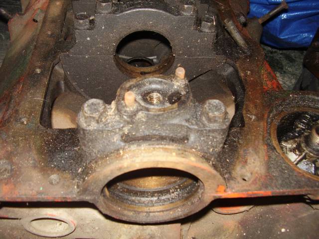

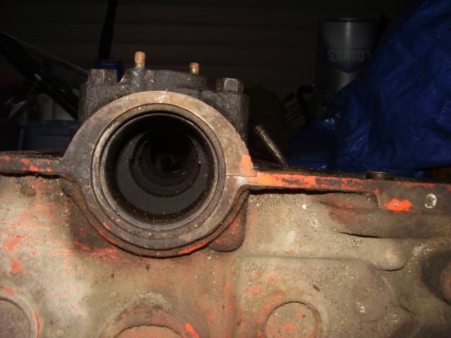

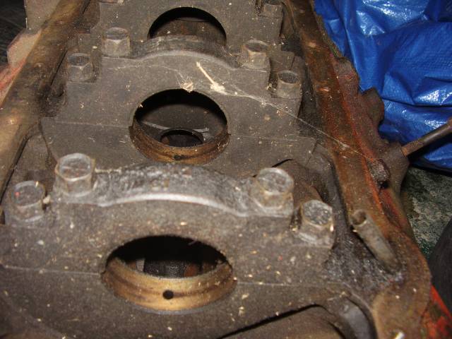

well i got a different 5.7 block for free so i am hoping that yall can help me out and tell me 2 or 4 bolt and 1 or 2 piece rear main seal
sorry about my ignorance but im trying to learn

Old Dec 25, 2010 | 09:17 PM
Damon's Avatar
Posts: 7,072
Likes: 13
From: Philly, PA
Re: 5.7 cracked piston
That's an earlier 2 piece RMS block. The wide groove just inside the rear edge of the rear main is where the 2 halves of the rear main seal sit.

On the upside it IS a 4bolt
