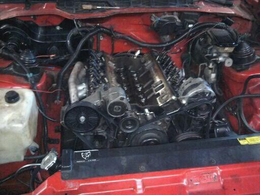

First off all credit goes to "sofakingdom" He has helped me with any questions along the way and picking everything out. So thanks man! So i figured id make a thread following my cam and head swap right now it has stock heads and a "RV" cam. Going on it are Dart iron eagle platinum heads (200cc intake and 64cc chambers) and a lunati 60103 cam.
Heres the car now:

Serpentine setup off and radiator out:
