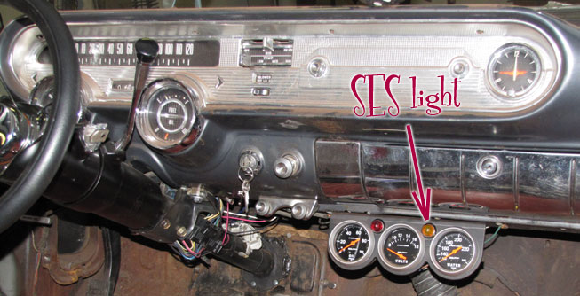

87IROC-DAN61, I must prove you wrong, as I really have an SES light in my '57. In diagnostic mode it shows that the engine is working closed loop. Even without the IAC connected.
Apparently the IAC is working just fine, closing up when it should, and opening up as the ECM commands it to. The throttlebody works ok too, I can get a very low idle, or stall the engine by turning the air adjustment screw.

Re: TPI idle
Of course it would be nice to go Digital and have a new crate engine with all the bells and whistles. This is my first try at fuel injection, and this has been a very interesting winter with a lot of studying.
A huge satisfaction was felt as the PFI mill started on the first try!
Also, I'm on a budget, and after selling off the Trans Am body the complete engine with electrics and ECM, the TH700 tranny and part of the brake system cost me less than $1000.
Any way I like this car very much, I think its a keeper, so the future will tell if I'm going to invest in DFI. It's certainly possible!
Here's a pic from one of the first outings a couple days ago:
My Pontiac project home page can be seen here: http://www.waasadata.com/pontiac

Nice, ASE doc, to get a response from somebody understanding a benefit of low idle :-) The most important benefit of low idle in my case is that I like it, and it sounds plain wrong with a high idle on a fifties car.
I'm pretty sure the prom is original, as the rest of the car and engine was, and everybody hereabouts are afraid of injection systems, they're like woodoo...
Can I reprogram my prom for lower idle, and if that's the case, can anyone steer me in the right direction?
I don't have any equipment, but I could get some if I'd know where to start.

Thank you, 87IROC-DAN61!
It works a charm too! I've added a switch between A and B terminals on the ALDL connector, so I don't need a paper clip to check the codes, and to check if the engine runs open or closed loop.
