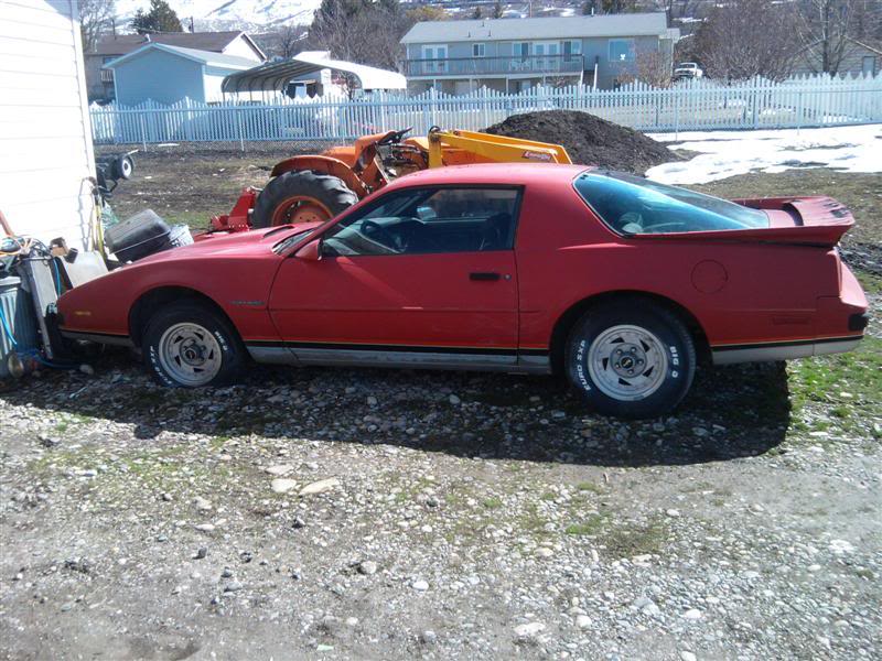

heres my v8 car that the 3L turbo motor is going into

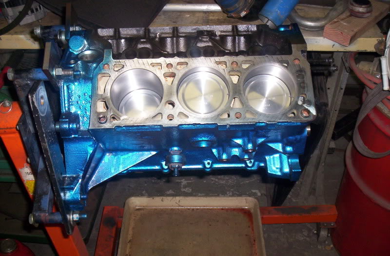

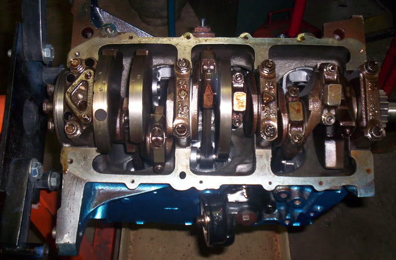

and heres a shortblock

so is this a 2.8 crank in a 3.4 block?
Old Aug 6, 2011 | 01:31 AM
project89's Avatar
Joined: Apr 2008
Posts: 10,401
From: Utah
Re: getting much closer to installing the 3.0
3.4 block std bore
2.8 crank
custom pistons

any particular reason for not building it as a 3.4? Only reason I can think of is for higher RPMs with the shorter crank throw, but its not like the 3.4 would have problems getting to high enough RPMs to hurt itself..with the weak lifter valleys these engines have..
Old Aug 6, 2011 | 09:49 AM
Guest
Guest
Posts: n/a
Less stroke = more journal overlap = can survive more boost.
