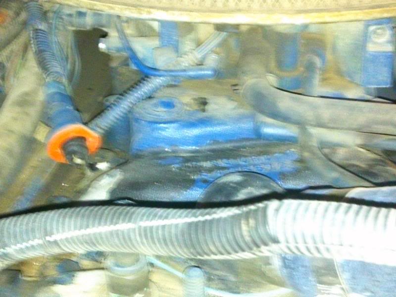

I got the casting number or most of it. I cant tell for sure what the 5th number is. I think its 1409(something)62. Its facing the rear of the car and was on the passanger side. I couldnt find anything like 305 or 350 in the number. Here is a pic of the engine if it helps. Feel free to give your 2cents about the "orange" sensor

Re: No Engine Numbers?
Still wrong
Last 3 numbers will be same as the 3 cast in side of block ; in your case 627
Most likely your block # 14093627
87 - 91 305
https://www.thirdgen.org/forums/engi...an-i-tell.html
https://www.thirdgen.org/forums/tech...ine-codes.html
https://www.thirdgen.org/forums/engi...ne-please.html
I couldnt find anything like 305 or 350 in the number. .
You won't , that # is cast on other side of block
5.0 or 5.7
