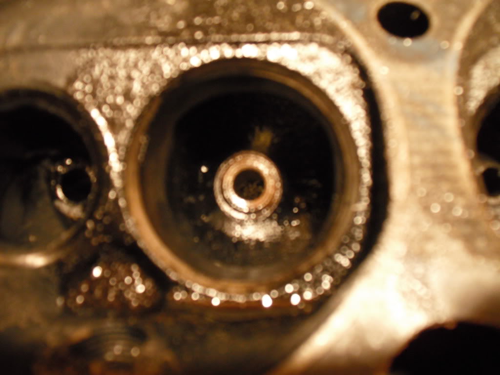

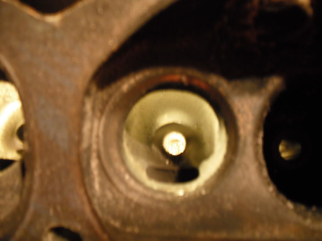

I started my grinding on these 416 heads;

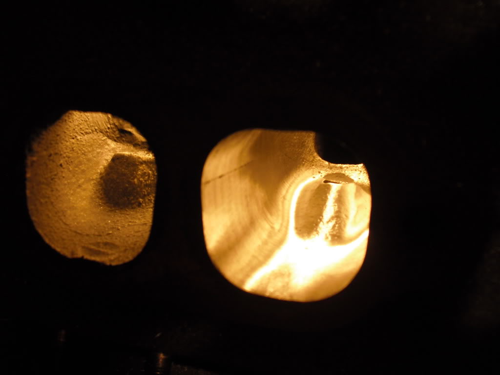

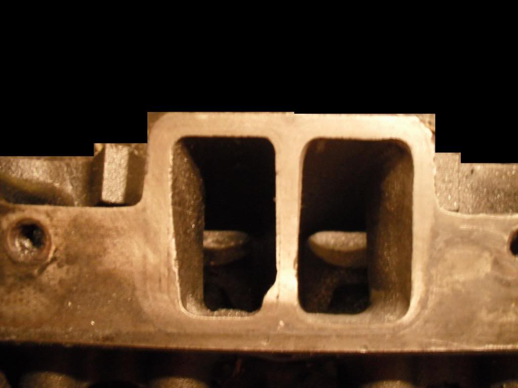

Old Aug 25, 2011 | 04:12 PM
Guest
Guest
Posts: n/a
Re: Considering using wrong cam, opinions?
