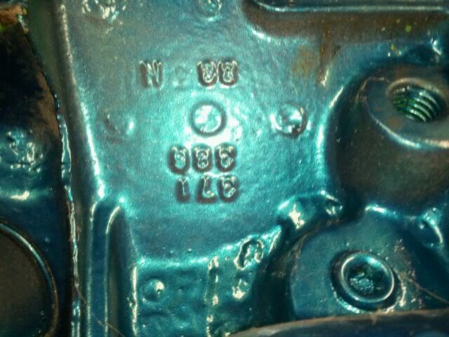

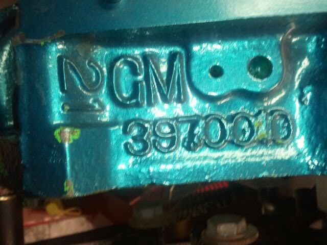

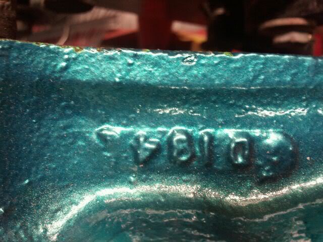

help me ID this block.
I can't get a defined answer when I try to find out if its a 307, 327 or a 350

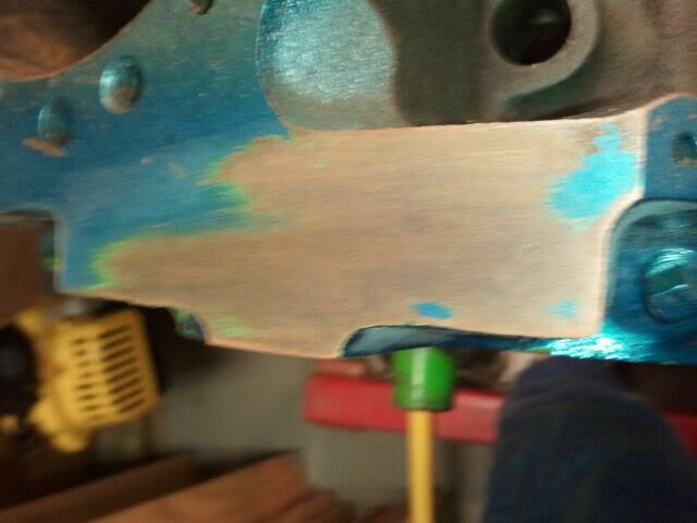

Re: help me ID this block.
That's the problem, there is no vin in that location

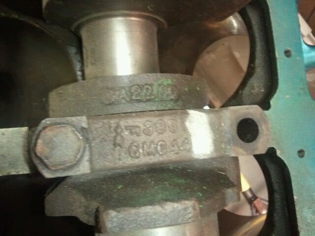

That's ok, the VIN doesn't tell you anything useful.
3941174 has a 3.25" stroke, 3970010 has a 4" bore, so it's a 327.
So your block has previously been machined, anything could have happened to it in 40 years
It was the 2 or 3 digit suffix code you were after ; not the VIN
A BLOCK is not an ENGINE so it doesn't have a CID "size". It's a 4" bore block.
It was used in the 302, 327, and 350, but not the 307 which has a different bore.
It's not a "350" or whatever until it gets a crank installed into it. Meantime, it's just a block.
Doesn't matter which of its possible sizes it started out life as, unless you're building a "numbers matching" type of restoration. None of that left any trace in it. Iron has no memory. Attempting to determine what it "was" when it was new is a futile non-productive waste of mental energy which only serves to demonstrate to people who know what they're doing, that you're a n00b, and makes them laugh at you behind your back. Your energy should instead be devoted to working on what it WILL BE next.
The crank that's in it is a low-perf cast crank for a 327, so that's what it IS now, regardless of whatever it STARTED OUT as. Perfect thing to throw in the trash and get a 383 crank instead. If the block is even any good: check how far it's been bored before making any plans for it.
