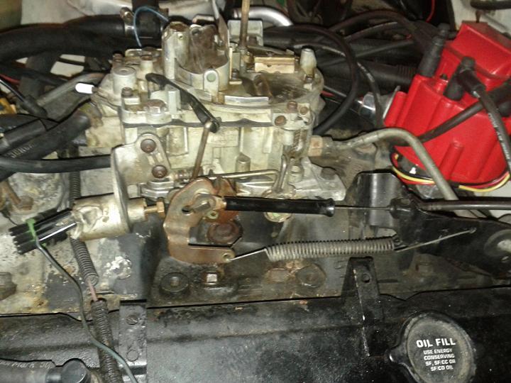

I think I figured it out. The part of the throttle that connects to the accelerator cable was sticking a little bit. I lubed it up but not helping yet. I'm trying to figure out how to loosen it some

can you post a pic of your throttle linkage and carb?

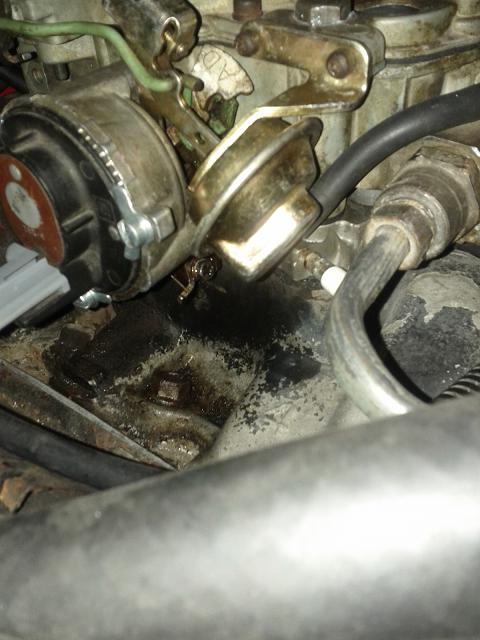

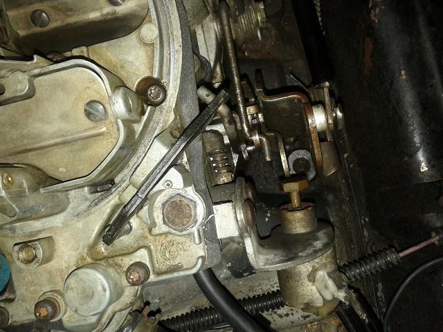

the pics, 1st one is of the problem area, where the spring and throttle cable (name?) is attached, its sticking a little bit. the last pic shows the little screw on the other side which is part of something that connects to the problem side..im guessing it all connects to the throttle blade..or something lol

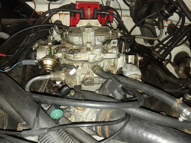

hope im not putting too many pics up, but one more

that is a mess. i hate OE carbs. i had an edelbrock on mine and i loved it. so simple.
what happens if you disconnect the vacuum line from that vacuum actuator on the pass side?

ha..yep ..im not gonna put more money into it right now because if i stay where im moving for more than a couple years ill have to sell the car, as it will never pass emissions. the carb is working great other than this little issue though, i might just need to pick up a new spring (the one under the throttle cable) if that spot has more tension it brings the throttle "thingy" back down to where it needs to be at idle..i know that thing sticking is the only issue now, its pretty obvious. i can check the vacuum line youre talking about but whats ur reasoning with that? (just curious)

i went and got another spring, actually had to use it and the old one together (new one wasnt an exact copy) now it idles at 800..tensions a lil high on the gas pedal, but no biggie. almost everything is working right now..just have the bogging when i push the gas all the way to the floor..i wonder if my secondaries arent opening up and therefore not getting enough air at full throttle..idk..just the 1st thing i think of
i mean the rear butterfly valve..not secondaries per se (i can never remember whether primaries are in the front or back part)

my reasoning with the vac actuator was to see if that might have been holding the throttle open.
in Massachusetts we don't have emissions testing on cars more than 20 yrs. old.
bogging can be caused by either a rich or lean condition. do you get any smoke out of the tail pipes when it bogs? or after it picks up.

hmm..i should check that on the vac actuator..i dont like the tension on the gas pedal as is right now. yeah, Philly area has terrible laws with that emissions stuff.
id have to have someone follow me to double check , but no i dont see any smoke whatsoever (that i can tell)
